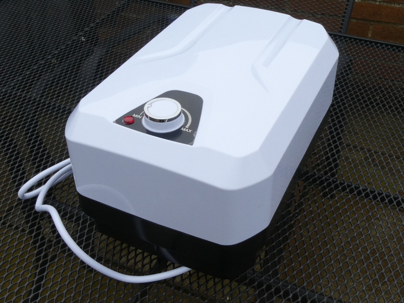

I installed our 12v 300watt (2x 150watt elements on the same unit) water heater nearly two years ago now and have each of the 150watt elements being fed via the
load output terminals on each of my two Victron 20A MPPT solar controllers.
Initially the MPPT's were setup to switch on the load output to the heating elements when the hab battery reached a set voltage and cut off when the hab battery voltage dropped to a preset voltage.
This worked fine after a bit of adjusting the cut-in cut-out voltages to stop it pulsing on and off the load when it was applied which causes a spiked voltage drop.
This setup allows for manual switching on or off of either of the 150watt elements via the Vicron app or Victron VRM, powering via the hab battery reaching the set voltage by the solar charging or by the B2B charging as well as EHU.
This was all well and good, but after a while, I found it just easier to leave it setup for the full 300watts and manually switch the power on and off via the digital thermostat and a couple of relays to handle the load switching on and off.
It does not take that long for our water to reach 58C and then it takes not a lot out of the hab battery to maintain the temperature via the digital thermostat.

Not really, but not a lot in our case as the water tank I used is fairly well insulated and the elements are only powered for a minute or two every now and again to maintain the temperature.
I converted a cheap 240v Chinese 8ltr water heater and it's plumbed into our existing hot water plumbing via a 12v 3-way motorised valve I fitted to use either the solar hot water or the hot water from our Whale water heater.
12v element fitted in place of the 240v element.

Looks like polystyrene Insulation. Do you know if the water tank is double skinned and any chance of a link?
Yes, the insulation is polystyrene and works remarkably well, but you could do your own thing. The stainless steel tank is single skinned.
I bought it off of eBay a couple of years ago, so the listing will be long gone, but this is the same sort of thing.
I found converting one of these was ideal because they come fitted with an over-temperature cut off, and a pressure relief/drain down valve, and the fittings are 1/2 bsp, so easy to hook up to John Guest push fittings, and you have a ready-made casing too. (y)
