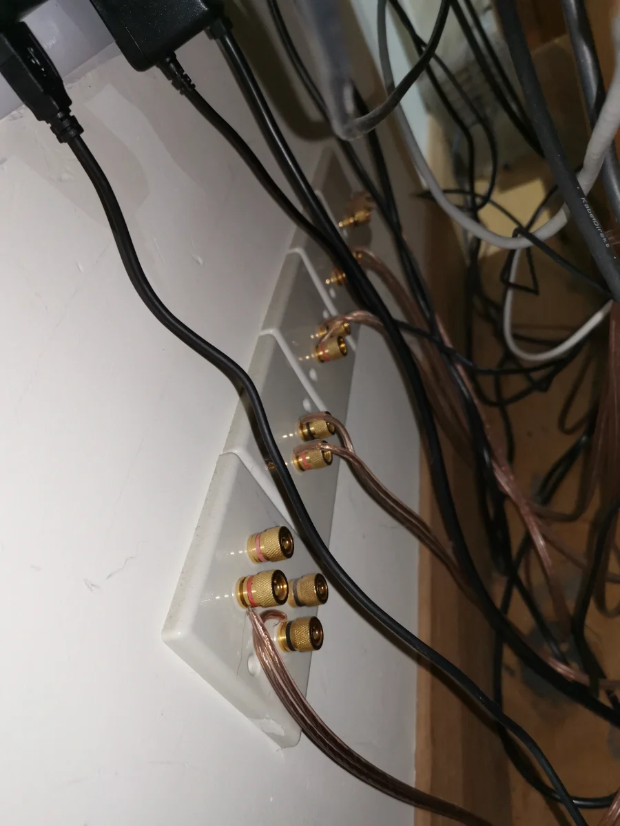

On a complete left turn, have you designed your surround sound solution for your main TV, and put in at least 7-8 sockets around the room, with underfloor runs for the cable back to the TV/amp?
Sorry for the messy photos!
Btw, I put 8 power sockets behind the TV. Wasn't enough! 🤦‍♂️
