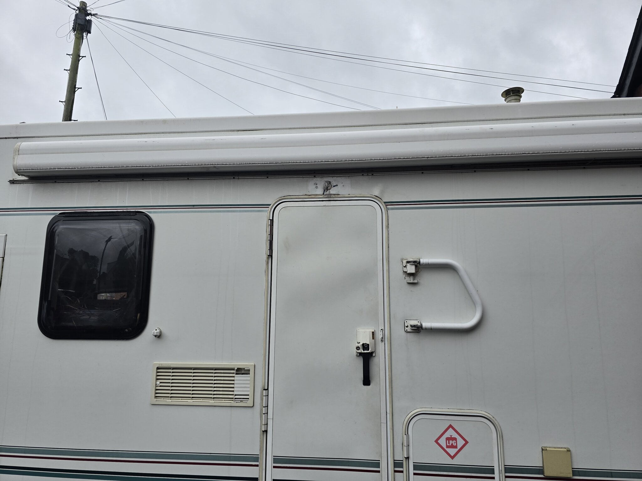

I could really do with some advice on what to do with my motorhome as I'm at the depressing point of just seeing it turning more and more towards a scrap item if I don't do something to stop the issue.
I know there will prob be damage internally as I don't know how long this water has been getting in, but I have a couple of external damaged areas I've found, and water has clearly been getting in, as internal wall board is slightly soft although no damp patches as such.
I just need to work out what I can do to stop any more getting in and deal with any internal structure issues once I know it's sorted, but I'm not sure the best course of action.
First is the hab door.....
Above the door is soft on the wall board where someone has badly installed an external light :(
I thought I just needed to deal with the holes left by that, but it looks I may have an issue with the fit of the door frame itself.
The side of the mh has a slight bulge for some reason at top right of door and I think this may be where water is still getting in. It's a plastic style body not sure on the material, but it's not the aluminium skins you see on some.
I don't know if I should remove the door to refit, or just run some kind of sealant round it. There is a load of old mastic around it though and I'm not sure if sealent will adhere or react or if it's even a good idea....
Pictures attached of where bulge is and where soft internally.
Is there anywhere northwest that deals with this sort of stuff that anyone would recommend speaking to? She's an old girl... 99 bessacar e695.
Any advice really appreciated. Please don't just say it's scrap or you've bought a nail.....I already know this but I need to now try and keep this thing going as long as poss. I can't afford to just chuck many thousands of pounds down the drain..... Although it's kind of feeling a little like I've done this.

Not myself. It had had a hab check a bit before I bought it where from what I could see were some suspect areas which were explained away and sorted. I got the check done again and the areas that had been flagged seemed to show better results so confirmed in my head the issues had been sorted.... This was my first rodeo so to speak and unfortunately I know more now than I did then about the structure of motorhomes etc.....
Not sure I need to use a damp meter though if I can feel soft wall boards.... I think that's enough for me isn't it?

I can't bring myself to start stripping out anything internally until I know the external areas are sorted.
Do you know what the method is of repairing cracked motorhome body, or warped areas? I think the warped area is stopping a decent seal for the door frame for a start, so until that is sorted I'm fighting a losing battle I think.

You need some positive thinking. Of course you can fix it. Or worst case get someone else to do it.
If it were me I would remove the door and then the frame. Strip the old sealant then refit with either non setting mastic (which is what looks to be there now) or puraflex or stixall.
With the doorframe out you will be able to see what the damage is to the interior of the wall structure and wallboard which you should be able to repair from inside.

Do you know how these doors come out. I can't see any screws. Are they rivited in?

I was assuming ( perhaps wrongly) that you had the skills and the tools necessary to do the door striping.
Your going to have to drill the rivets out I'm afraid.
Holding the door while getting it out and putting it back is definitely a 2 person job.

Having done a few, if you can stand back a bit from the door and take some interior pictures showing from the ceiling down, do not attempt to remove the door frame at this stage. Check any roof lights for leak as water flows in some strange places. If after looking at your photos the probable course of action is not to touch the outside at all to start with other than removing any sealant etc from around the door frame.. If it was me I would remove the internal board slightly wider than above the door frame to get an idea of how far the damp has spread also if you can see any daylight. Probably a wooden frame with insulation bonded to the outer skin. When it is cleared away and dried out, possible ways to correct the bulge are cut a piece of marine or varnished 3mm ply bond both surfaces with good contact adhesive and have someone outside with a thick piece of ply wrapped in a blanket press the bulge in hold it there whilst you put the 3 mm ply up against it from the inside if the bulge wonā€™t flex you may have to drill some small holes right through the skin outer and inner ply and use threaded bar to clamp it together the fill and cover the holes. With respect given the age a couple of small holes will not effect its value but fix your problem..

The water is almost certainly getting in at a higher point than the door top so you can assume that if itā€™s not the door seal itself, it will be the roof joints.
I would remove as much mastic as I could, clean everything to perfection and reseal again with new mastic whether it currently looks like it needs it or not. This first stage is relatively simple and doesnā€™t need any amazing DIY skills.
Once the structure is sealed, dry the interior and then decide if it is going to be good enough to leave alone or if it will need stripping back and replacing. This will be more involved and expensive but it shouldnā€™t be getting any worse if the outer skin is watertight.
It's soft across the whole top of the door and can tell it's bad in the center where the whole comes through for the outside light. I think I've got that temporarily sealed though but after rain this weekend I think water was still getting in where the bulge is on the outside. I tested this by sliding tissue paper in above the door frame from the inside.
It's not soft in the cupards or any further than round the top of the door and there is no evidence of water getting lower to the floor or anything.
The outside light I pulled off had basically had a big open hole so god knows how much has been getting in through there and for how long.
I've got a gutter exterior light that I was hoping to fit to divert some of the water away from the door, but the bulge is making that a bit awkward.

The bulge in the door looks quite bad but might be repairable if you can remove it and dismantle it ? Can you rig up a temporary cover for the door opening whilst you repair it ?
Is it aluminum skinned ?

As in outer skin? Whole motorhome side?
no the door.
