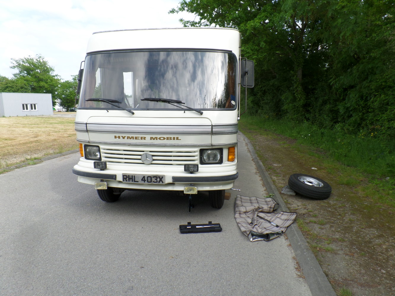

I have removed all the dead carpet remains and scrubbed the floor over first pass and very pleased with the result.
Sarah was having a new cooker delivered this afternoon by M. Darty and it was time to move Helen into the garage where I will change the gear box.
I appear to have confused Dennis who. moved his car out onto the road so I would have more room to manoeuvre - the plan was for me to drive out turn around drive straight back in and reverse into the garage, which is what I did - eventually. Having communicated my intentions correctly I drove out turned and drove back in. Now all I needed was reverse - which I could not get (yes Jim, you could not make it up). What's more, I could not get it out of first either as the clutch pedal was to the floor and doing nothing. Happy days. I popped the front and went round to check the fluid level on the clutch master cylinder. Interesting, no reservoir on clutch master cylinder simply a hose from the brake fluid reservoir and guess what - on the slope I was on that pipe was exposed to air and that is why I had lost the clutch.
(I did not realise it but Helen was talking to me again and proving once again what a jam strangling lucky clump of earth with grass growing out of it I am)
Blast I said. Then asked Dennis if he would drive me over to Lombez so I could get some brake fluid. Needed to go straight away as about 1130 and shops shut at 12 for a couple of hours.
Whipped over bought fluid and returned. I checked manual to see if any special procedure for bleeding the clutch - oh good, yes there is see lack of reservoir above. I topped up the brake fluid reservoir, gave the clutch pedal a couple of pumps in the vain hope of divine intervention - zilch!
Oh well, grabbed a lump of old carpet, time to have a look underneath and see where the slave cylinder is. On my back looking up can't see any sign of slave cylinder on LHD offside BUT I DID SEE A LEVER HANGING OFF ON THE SIDE OF THE GEAR BOX - ONE OF THREE. I called Dennis to come and have a look - prefaced with the immortal Victor Meldrew "I don't believe it!" Dennis was impressed as I was and I smiled at the thought that I could skip getting a gearbox. I asked him to keep his fingers crossed and we were summoned for lunch.
After lunch - leisurely here dans Le sud I thought I wonder if I have got lucky and she has bled herself in my absence. I gingerly pressed the clutch pedal and felt pressure, a few pumps and she was back, brakes OK as well. Now pre lunch I had hooked the linkage back on pending driving into town for fasteners but I wondered - have I or have I not got my gears back (please say yes I was saying to myself) Dennis reappeared an I warned him I was going to start up.
Bingo, the clutch was working and I did not do a kangaroo hop onto their terrace. I tried each gear in turn YAHOO they were all there. Reversed Helen into garage and minutes later Darty arrived in a large truck with the new cooker. Had I not been as I keep saying such a lucky devil I would have been really in the way (I suspect my hosts were wondering what PITA* was going to do to get it out of a very inconvenient place on their drive).
Someone or something somewhere is certainly looking after me.
