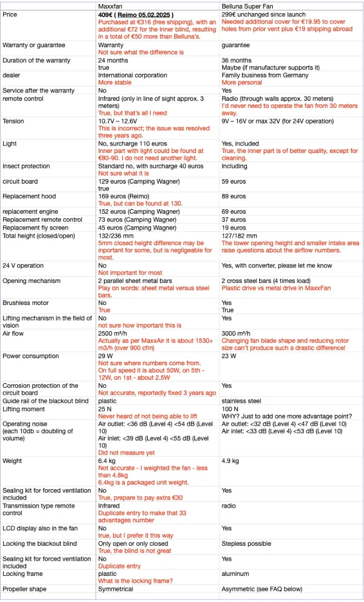

A word about the honesty - I decided to install MaxxFan. One of the primary reasons was that I felt the comparison information table posted on the Belluna website was, well, less than straightforward. It created an uneasy feeling.
Here’s the comparison table from the Belluna website, along with my comments about items I find not entirely accurate (maybe it will help someone to make a proper decision, which maybe for the Maxxfan or for the Belluna fan, depending on your needs):
Comparison with similar products* (33 reasons why you should choose the Belluna SuperFan):
Also, listing the price difference of every replacement item as a separate advantage point is a pure marketing - why not just say that the replacement parts are less expensive?

I think (and it is only a guess) that the "insect protection" might be the bug screen which I thought was standard as part of the blind?

Yeah, if the insect protection is removable interior accessible bug screen, then it is another “inaccurate” information.
