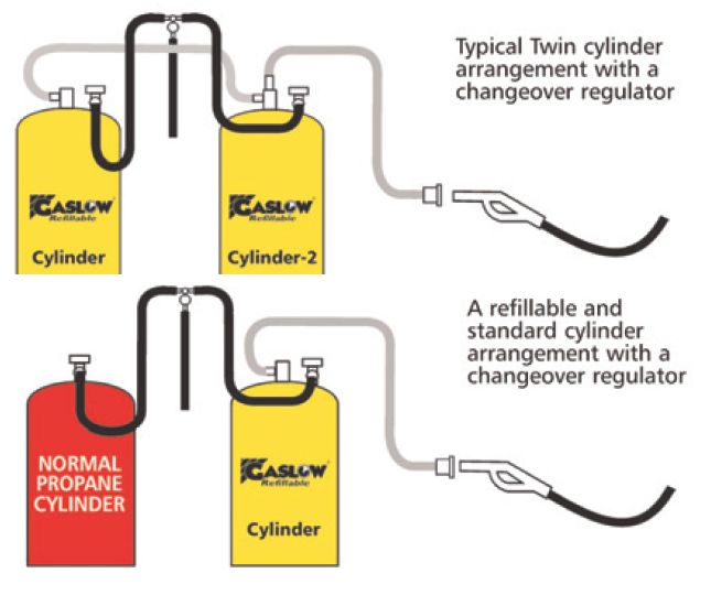

A couple of diagrams here from Gaslow that shows a couple of systems
