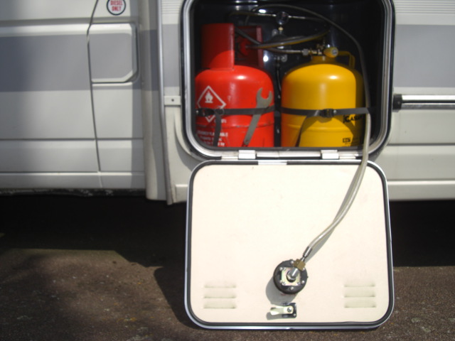

I fitted my system (a Gaslow plus a Calor as reserve) with the filler in the door using the right-angled connector as per Gaslow's instructions. The hose isn't stressed at any door position. If I change my system to another m/h I'll simply fit a vent over the hole in the door.
