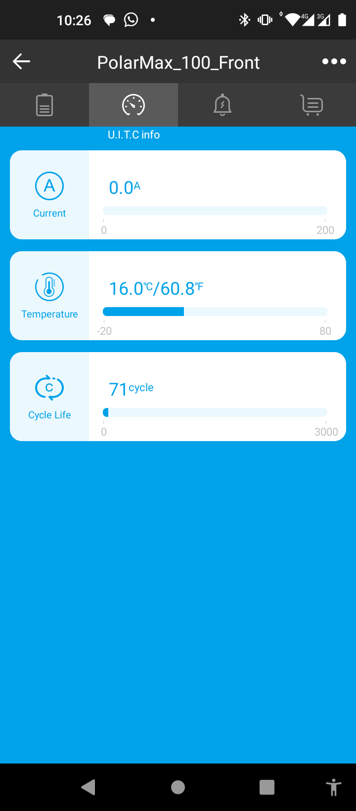

And Info for Current, Temp and Cycles to date.
View attachment 752971View attachment 752972
(temp is to -20C as the batteries have integral heaters)
