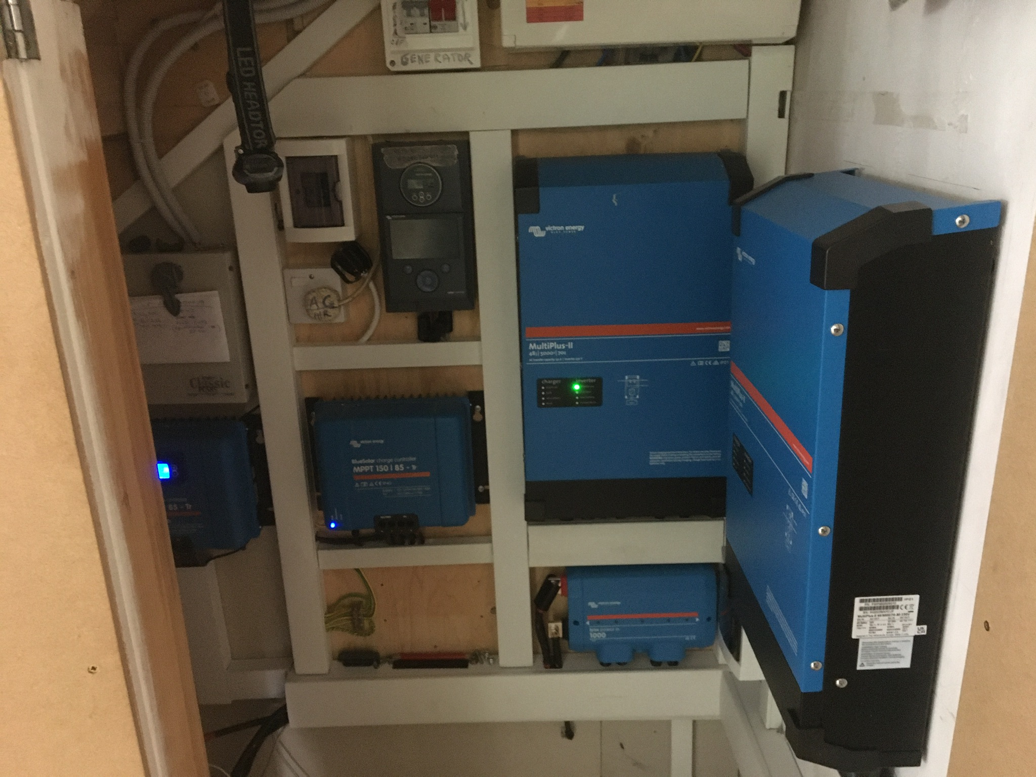

This one may be a contender, my 12v loads are continuous, but not to high peak. I never exceed 30A even with two compressor fridge and freezer. The 12v loads distribution is fed and protected by a fast blow ANL fuse, and in the last 4-5 years I never changed it.

The funny thing is, I just sold a multi 3kva, and a multi 2 5kva both 48v. Reason? I wanted two multi2 in parallel of the same revision and same identical hardware, to be able to run in parallel. What victron or dealers fail to mention, when you parallel 2 inverters, they pnp number has to be very very close or identical. Reason? Continuous revisions implies hardware add ons that changes the resistance of the unit, and make it impossible to sync to each other. So if you have one older that six months, chances are will not parallel.
Anyways for the van, a 3kva multi2 it’s nice, currently I have a 2kva and haven’t maxed it out yet. But, I tent to believe a 24v will be more appropriate since many appliances will take the 24v directly. My fridges take either 12 or 24v. A pump change is ok, a heater maybe, tv router lighting running on a 24-12 DC buck will work.
There is another consideration: winter power rationing, I’m glad I can switch the inverter off, and be very frugal on 12v if needs must. With the DC buck I will have no choice but to leave it on, hence efficiency is important. Currently I have 5kwh lfp, 2x 200ah, and could be re configured for 24v. A 48v would be a new bank, and sell existing at a loss. Very difficult decision.

Not an easy decision then. Sounds like you have a set up that already works for you. For me I would be starting from scratch hence not so hard.
