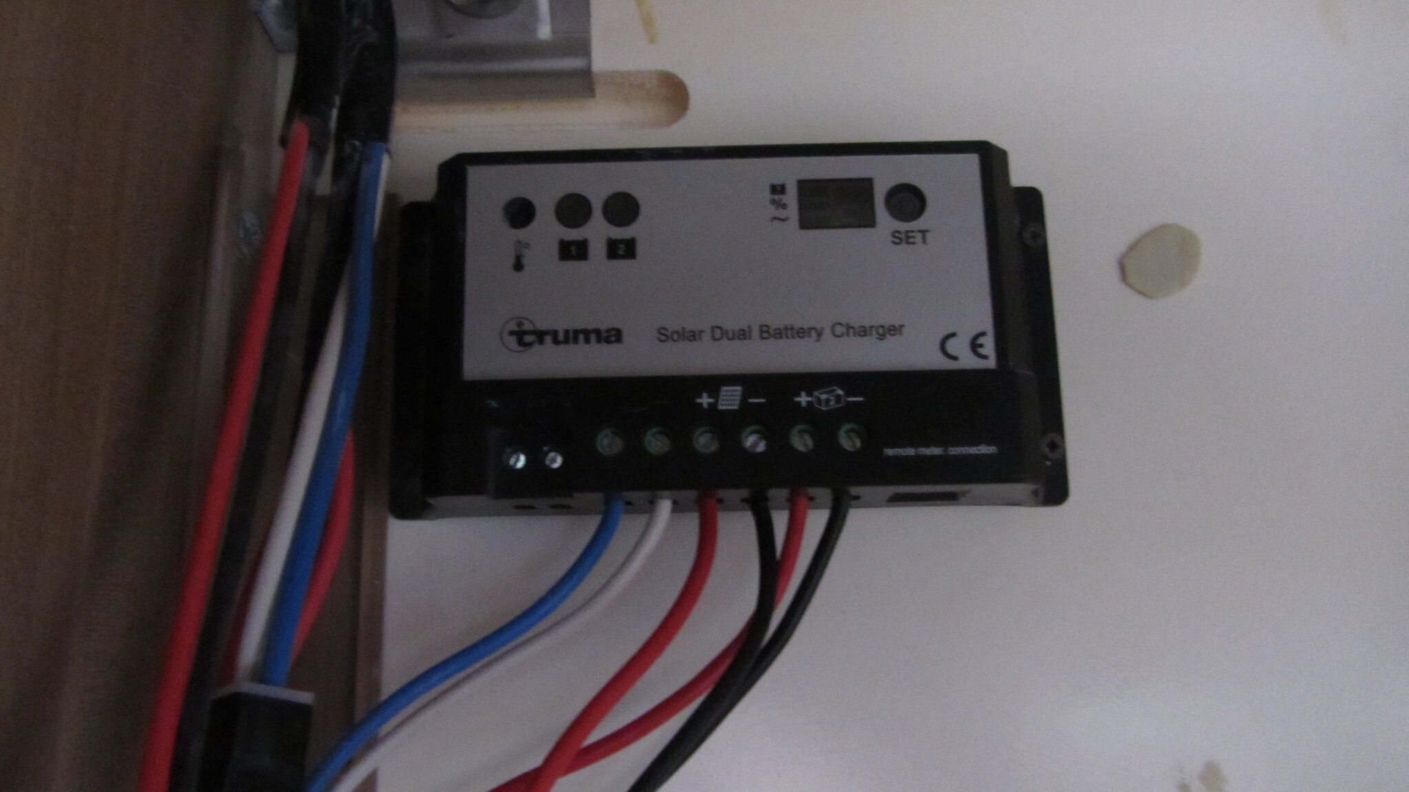

Easy way to check - not fullproof - look at the solar controller, if it's a pwm, then B2B not fitted, on the other hand if it's a mppt controller, then it should have a B2B fitted.
Location of solar controller - either in forward top locker on O/S, if fitted facing you WILL be pwm, otherwise in small cupboard forward of top locker, fitted on side of cupboard - due to weight - it will be mppt. Checked at NEC last year.
B2B if fitted will probably be in bottom of wardrobe behind front passenger seat, mounted on bulkhead.
Will post picture of pwm controller later.
Truma pwn solar controller fitted to Bailey 68-2.

PaulC70 the 2 leads to the battery appear to be 1 for 12v charger and the other is the feed from the alternator - it's the later I need to confirm.
