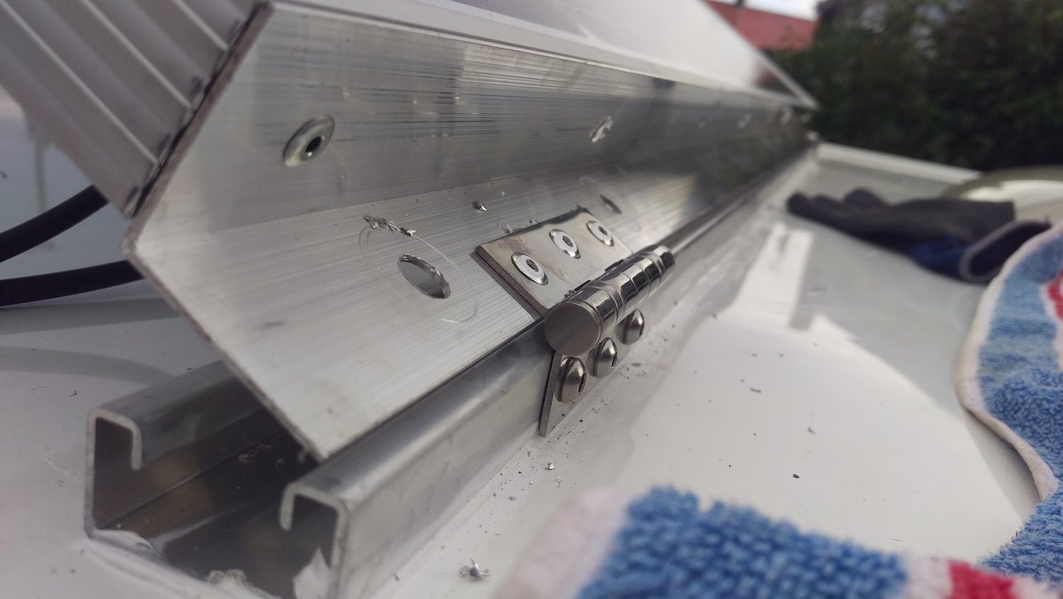

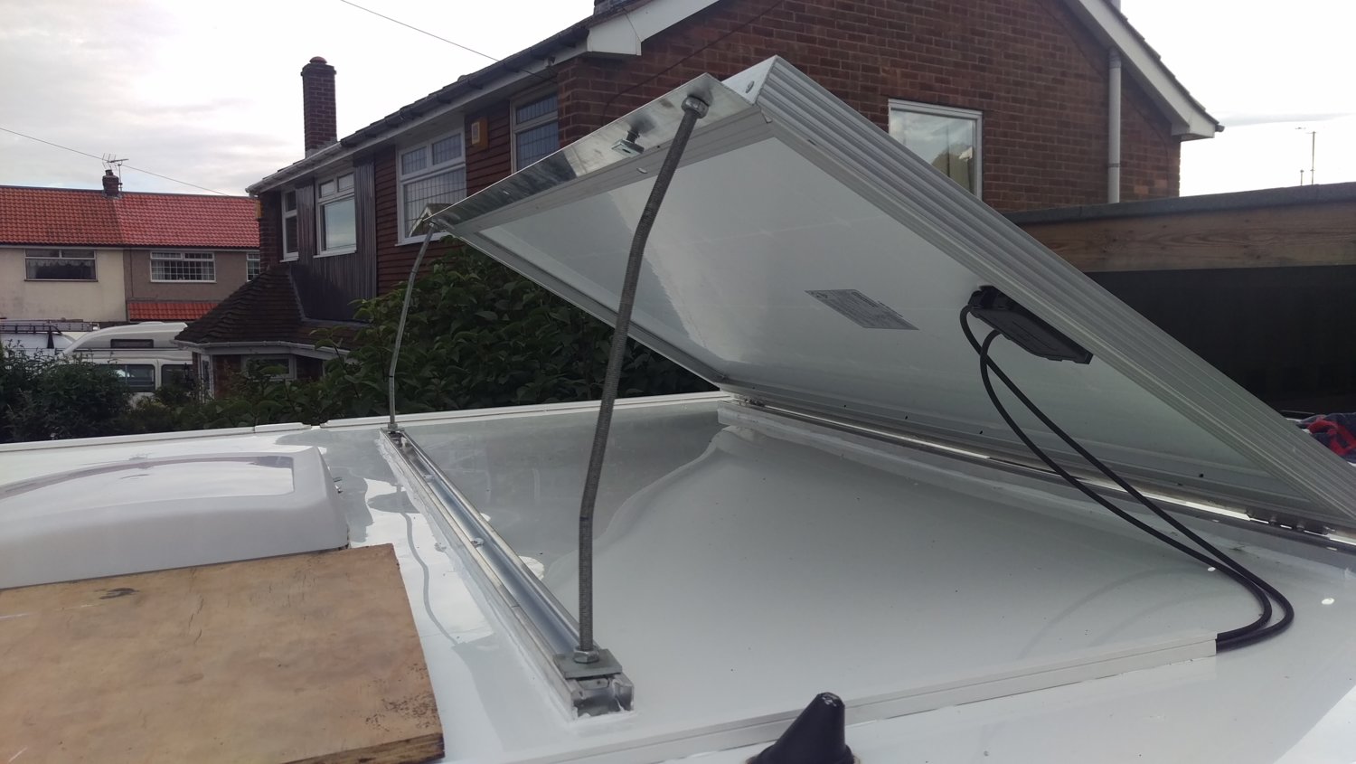

Fixed ours down with hinges, then I can tilt it if I want. Handy for later in the year, makes a big difference ??

How do you elevate it?
Do you have to climb on the roof?
