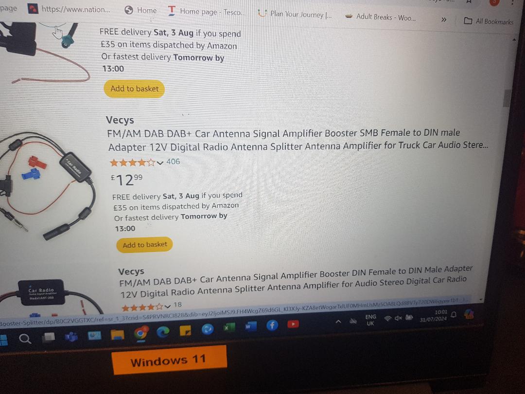

Me too
Fitted FM and DAB signal amplifier booster, pull out radio , very easy to wire .. even for me who has no electrickery knowledge.
( Vecys Splitter 1 .. at Amazon £13 !)
Have gone from a pathetic 5 DAB stations to 75 odd and has 300% improved FM radio signal.
On my van the arials are in the wing mirrors.
Huge improvement for £13.

Hi pwilmo, was it this one that you purchased please?
