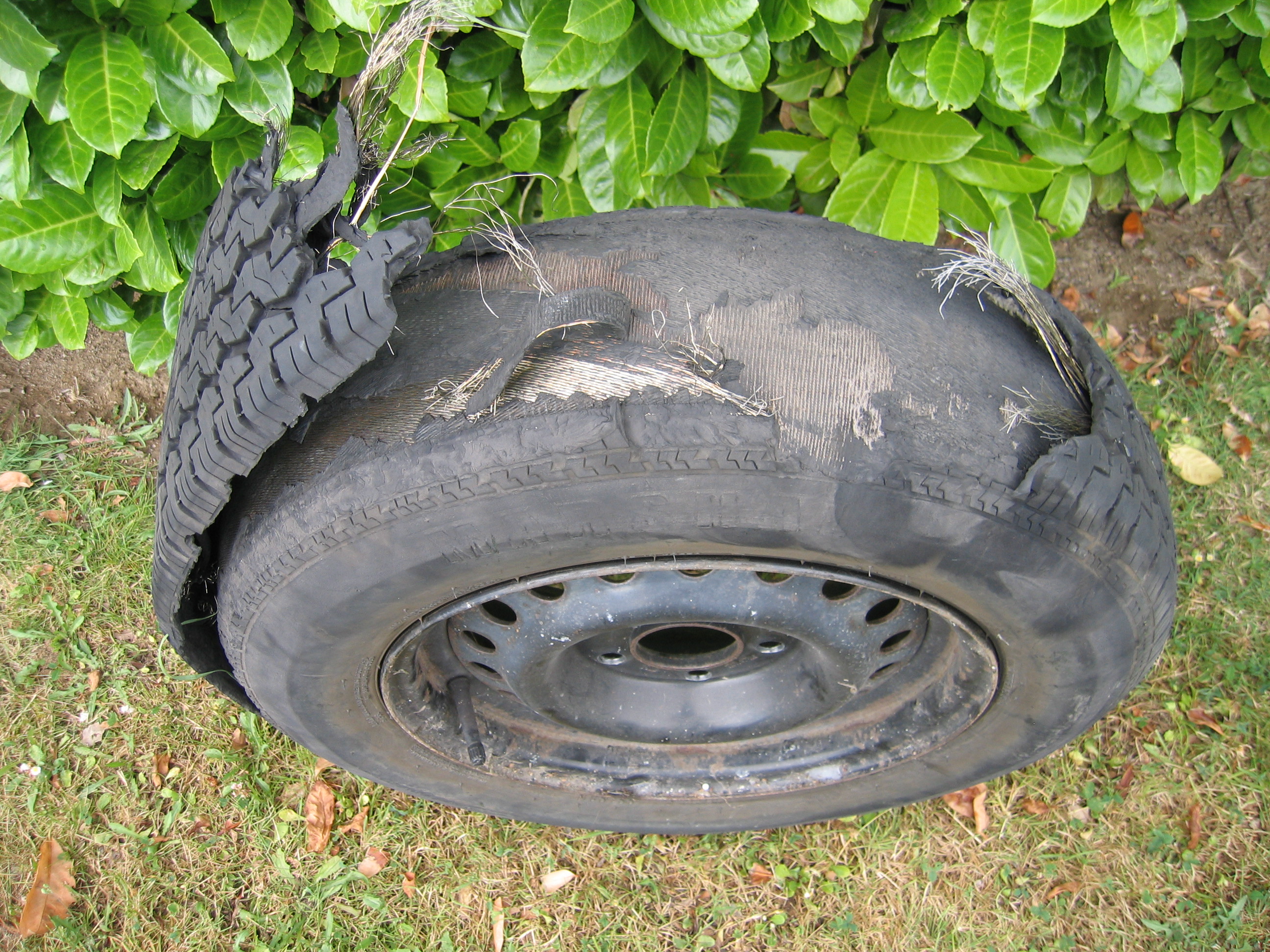

Caravan tyre, not motorhome after about 20k miles and 4 year use. The problem was caused by standing in one spot over winters. The tred looks great. Fortunately had a spare as Strassbourg a bit too far from Kwikfit.

Caravan tyre, not motorhome after about 20k miles and 4 year use. The problem was caused by standing in one spot over winters. The tred looks great. Fortunately had a spare as Strassbourg a bit too far from Kwikfit.View attachment 721550
Looks like a remould.
