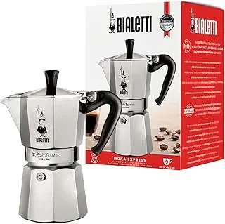

We use one of these, excellent brew every time and zero volts.
:giggle:

Here we go, to make a perfect espresso ☕️ just get a Moka pot. To enjoy a posh espresso buy it from John Lewis https://www.johnlewis.com/bialetti-moka-express-hob-espresso-coffee-maker/p1407523
Then get some excellent t beans from Dark woods coffee
All of the above will save you around £2,950.00.
Brew and then sit back savour the espresso and your genius in saving so much

And a milk frother for £10 Milk frother

This is being pedantic (on my part). But a moka pot doesn’t make espresso.
It can make a lovely strong coffee. But it cannot produce the pressure for an espresso.
Want espresso? Good manual options are the picopresso, the Cafelet Robot or the Flair 58.

What a Moka does is give Crisp and clean brews with lots of clarity.
I can’t disagree with you regarding how the coffee is extracted though
Absolutely- a Moka makes superb coffee; requires a grind size between expresso and aeropress though to make it really shine. For years most Italian’s used a Moka as their go to for at home coffee. Not even trying to compete with the expresso machines in their local cafes.
Everyone should have a Moka!
Agreed and save a fortune on 'Pods' and get a decent Coffee at the same time
