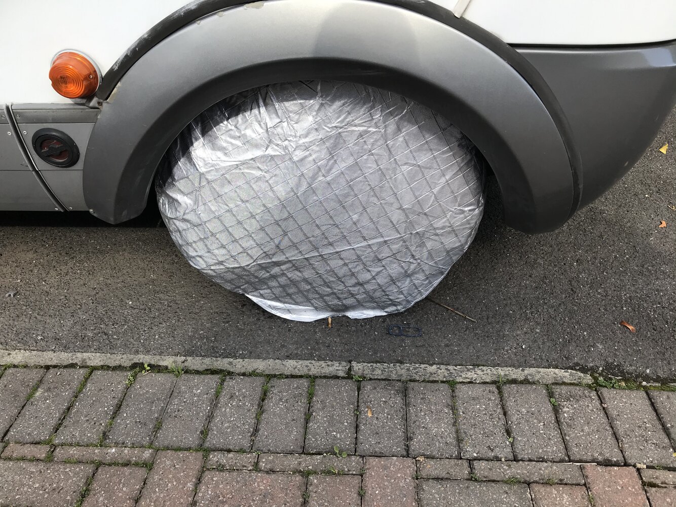

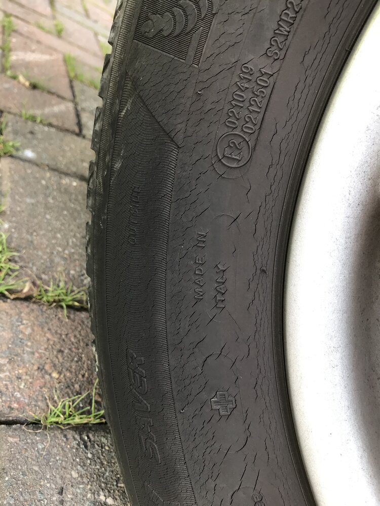

Don’t get too excited about any longer life or reliability from Cross Climates. I’m about to kick off a complaint to Michelin over mine where two out of six tyres are showing cracking. The offside front and near side rear outer. Could be worse on full inspection as haven’t had wheels off yet to fully check. They have covered a paltry 6k, covers used to reduce UV, run at correct pressure monitored by tpms. Load index and tyre rating for van spot on and it‘s never run overweight. Tyres manufactured 11/18 and fitted in July 2018 so not even 3 years old yet. I’ll probably start a new thread so folk can see how I get on with complaint although not expecting much joy.

I’d certainly agree with the ride and particularly the grip. Mine took me around Madrid in a snow storm 2019 and got me off a muddy Cl this year. I’ve thought they were great tyres up until the crazing appeared.

Whatever happens re my Michelin complaint I‘ve lost confidence with the Cross Climates. I had Toya on previous van with no complaints and no cracking! I just might consider them once again.

These were the tyres I had before I fitted the Cross Climates in July 2018. They were just over 6 years old but had no cracking or crazing and lots of tread left but replaced due to age.
4 years old, slight cracking View attachment 427793
I’m booked in as part of the complaints process to have my 30 month old Cross Climates looked at. I’m wondering what reasons they are likely to come up with to be able to blame me for some neglect or misuse on my part. Maybe running too close to their max weight or cold tyre pressure? In looking around at other brands though I can find nothing for the size of 195/70/r15 with a higher load index than 104.

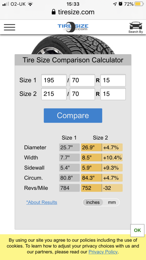

They will perhaps suggest I may have run overweight? I know that’s not so but maybe a hard one to disprove.
If you can increase the tyre size to 205/70/15 you can get to 106. 215’s will get you to 109LI.
depends what margin for increase you have on wheel arches, suspension geometry etc.
