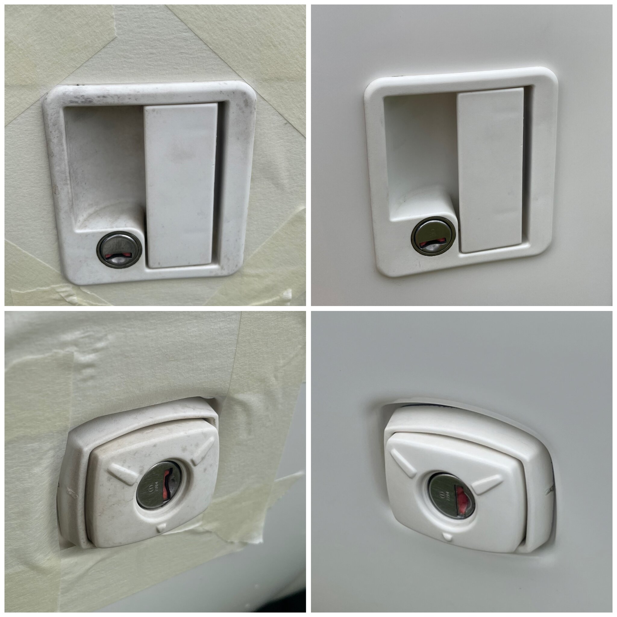

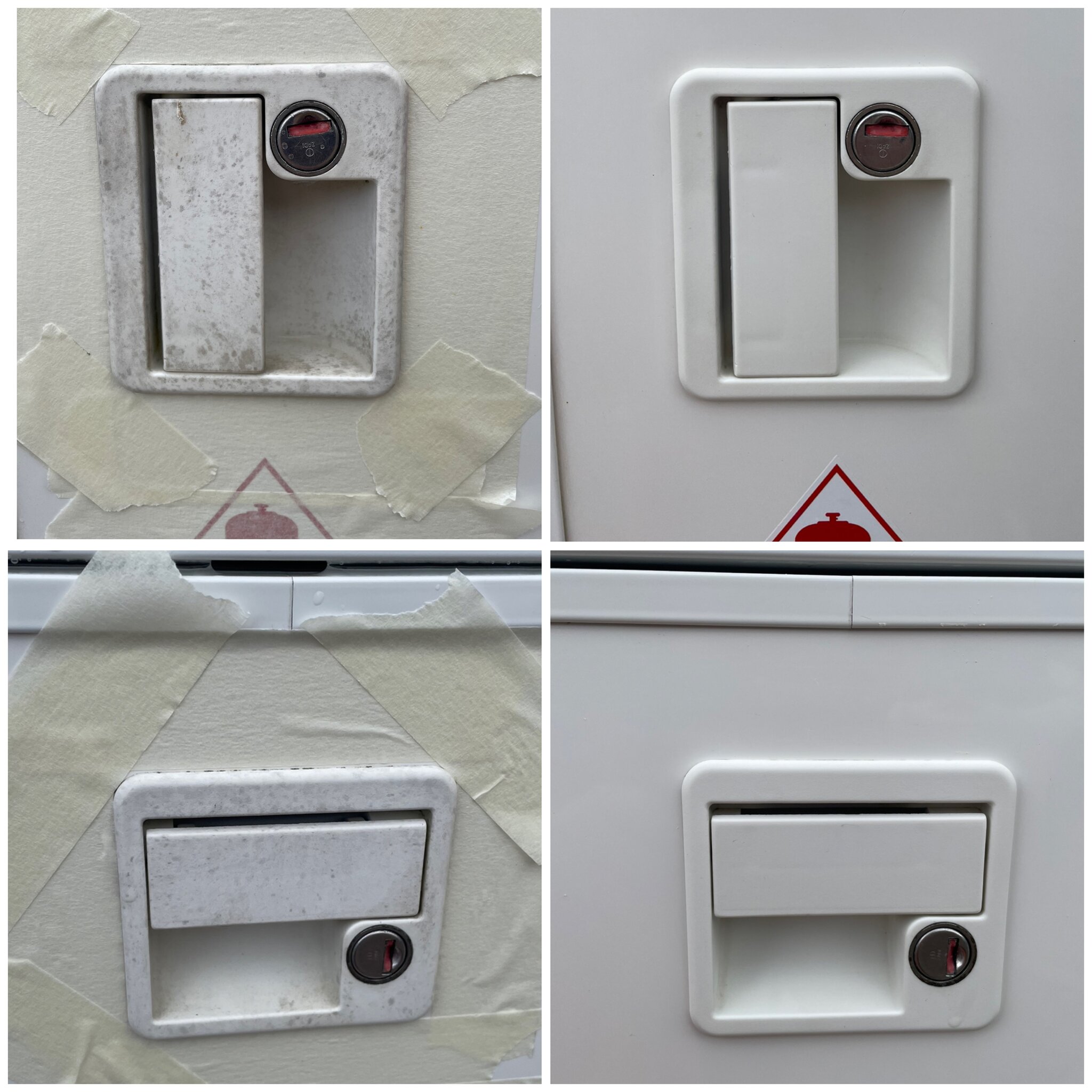

Some before and after pictures, all done in less than an hour.
Mask around handles
Clean with a soft scouring sponge and Cillit Bang black mould remover
Rinse with lots of water
Remove masking tape
I finished off by using a detailing spray (sonax bsd) to give some future protection.
Also works great on Fiamma end caps…

That Cillit Bang black mould remover is brilliant at cleaning. I also use it on my worktops to get rid of tea stains. It smells like it contains bleach which is why it is so good.

WHOA!!!!! Thank you SO much. I was actually going to be posting soon about replacing the handles on our MH, as they look so disgusting. I'll be trying this method first, now! :cool:(y)

I've been cleaning the trims on my MH today, that have been heavily spotted with black mould and / or dirt. I also did the cap on the water in. Pics to follow. Prepare to be amazed! :cool:

Amazing! I honestly can't believe the difference!! I'll get some pics up soon but I'm just watching the match now (and we're one hour ahead) and tomorrow I have a scan that I'd rather not go for, so it may be a couple of days. But, in the meantime, thank you so much for your post. It's definitely helped me! :)

OK, here you go, my before and after pics of cleaning the trim on my MH. These trims and the water filler caphad become really grubby and stained with mould and dirt. I was very close to asking where I could buy new ones (including the surrounds on the garage handles, as they were the same) when I spotted this post by M-J and I'm so grateful!! You can see the results for yourselves.
All I did was spray the Cillit Bang Black Mould Remover on the dry trim, wipe the excess run-off off the surround paintwork / plastic trim, wait about 1 minute (in which time you could see the grub disappearing!) and then rub with the rough side of a damp non-scratch pad. It was like magic!! I didn't even need to rub very hard :) Once I'd rubbed it clean, I rinsed with clean water and hey presto!! I just used a toothbrush and water on the algae :)
