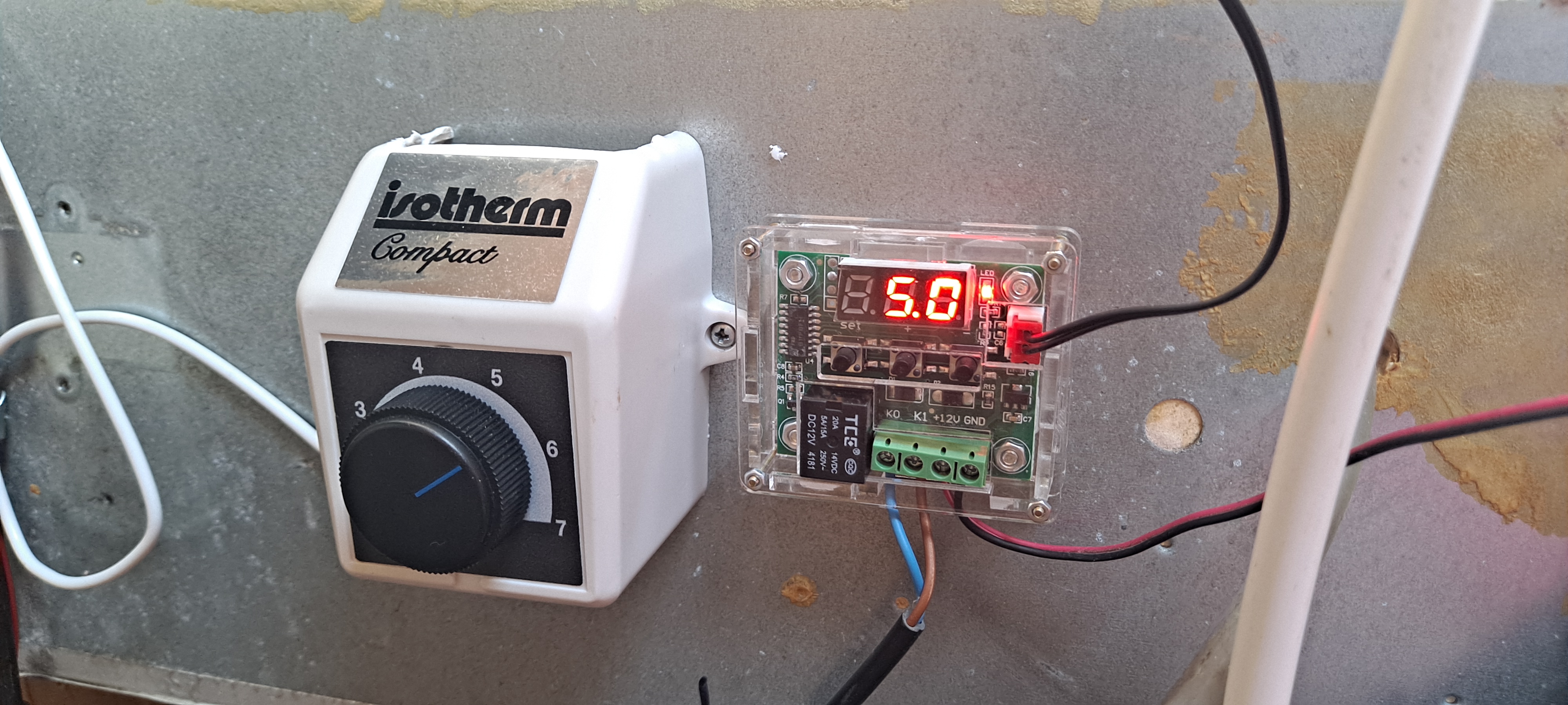

Right that standard thermostat is ridiculous, it was switching the compressor on every 5 minutes. Fitted a little digital module this morning for full temperature control 👌
It has differential settings, compressor protection, probe offset and even alarm 😎
Positioned the thermistor to sense cabinet temperature 3°c with diff of 2.
No defrost setting but I can sort that manually.
Much better now, switching on about 3 times an hour rather than about 10 times according to the battery voltage graph.
Earlier I timed it to run 14 minutes, then off for 10 minutes so just starting up every 24 minutes. 👌
Well that Chinese module thermostat thing didn't last long. It started switching on and off randomly yesterday, couldn't do anything with it so I've reconnected the mechanical stat. 🙄 I'm going to look into fitting a standard 29x71mm controller.
