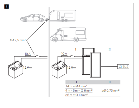

Think they went a bit over kill unless your original wiring was crap, 10mm so roughly 70amps, what is the fridge rated at?
Which Dometic Workshop fitted this and was it under warrenty or cost to you
Tewkesbury workshop.. cost £2,388 RCD10.5XT
rather have bigger wires than smaller :rofl: i will get my pop corn out as well 🍿
1967bowesj correction wiring 6mm fuse 10amp

They probably fitted a different 12V feed to the compressor fridge because the original 12V feed turned off when the engine was turned off.
The original feed would easily have been good enough, if only it didn't turn off when you turned the engine off
If youre only using 1/3 the amps you don't need thicker wire and if a small invertor can run a 240v fridge there cant be much inrush current.

The original 12v element feed does turn off with the engine, you have to find the cable at the fuse box and make it a permanent fused supply.
I've used the element cable for mine, but I'm going to replace it with a thicker cable after this trip as I've noticed a couple of times when I get up for the toilet at about 5am the fault LED is flashing the low voltage code, it does start up after about 4 attempts and the battery isn't at the 10.4v cut off but it must dip down just for a microsecond at start up.
Startup current is similar to a motors LRA (Lock Rotor Amps) and can be 6 times the full load run current, and even more when the voltage is lower
You wouldn't need much seperation between battery and fridge to exceed a 6mtr cable run there and back.......
But is that there and back or one way, try looking up voltage drop fir those lengths
Knowing your electrical knowledge is it not possible to fit a soft start ? Richard n Ann
Yes it's possible with DC compressor motors... But the Danfoss (secop? 🤔I think they call themselves now) compressor on my fridge has it's own microprocessor module that runs the motor so you can't really change that 🤔
The voltage drop calculator I like uses the one way circuit length for the calculation i.e. it assume the electricity has to do a return journey.
Why would I try and second guess the engineers that designed and developed the equipment.......as to is it there and back or one way a quick email to the tech department would establish that.......
