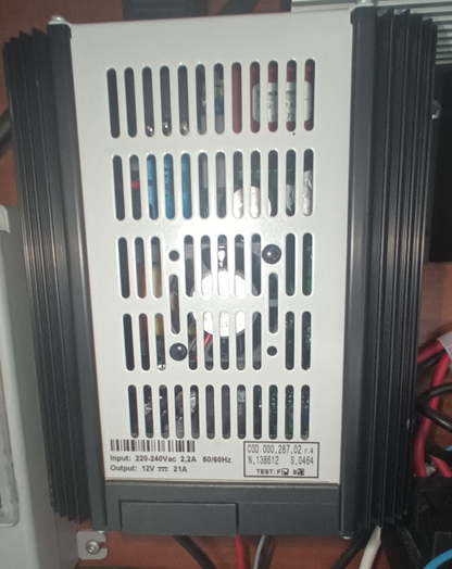

Need a tad of advice.
I don't understand electrics. The terminology and acronyms mystifies me. As Donald Sutherland said in Kellys Heroes, "I only ride 'em, I don't know what makes 'em work."
We use a lot of EHU. However, we intend to do more overnighting, so no EHU. I want to make sure that when we do, we have enough leisure battery DC to power the essentials. Telly, charging, lights, tablets.
My question is simple. Can I take out the old 100amp battery and put in a 150/200amp lithium?
I've currently got:
1. Platinum Leisure Plus 100 amp battery, don't know whether it is AGM, gel or wet. It doesn't seem to hold charge anywhere near to where it used to. 6 years old.
2. 150w solar panel, twin relay
3. An electric solar panel thing with MeTer on it. No idea what it does.
4. An inverter
5. A dual battery solar controller that doesn't seem to be doing owt.
6. A distribution box with fuses in it
7. No idea what this is.
Is a lithium battery a straight swap, or do I need to do something else? Is it DIY or expert fit?
Many thanks,
Dave
Dave
Dave, Not an expertonly in years. You seem to have system designed around Lead acid battery. aA change to LiFe is supper major & costly , I doubt if you could Diy it for under £1000. Check out the inverter, sure you can get better size match improved efficency. Speak to Tanya batteries re new Battery . tony
Cheers, quite happy to scrap the inverter. It was fitted by a dealer who seems to not have known it was unsuitable for our van's setup.
If you are having 200AH of lithium fitted then that will run your inverter fine.
Just be aware that some items don't like modified sine wave, although TBH I ran a modified sign wave inverter for several years and never had a problem.
If you keep the inverter I would check that the 12v cabling to it is up to the job and correctly fused.
