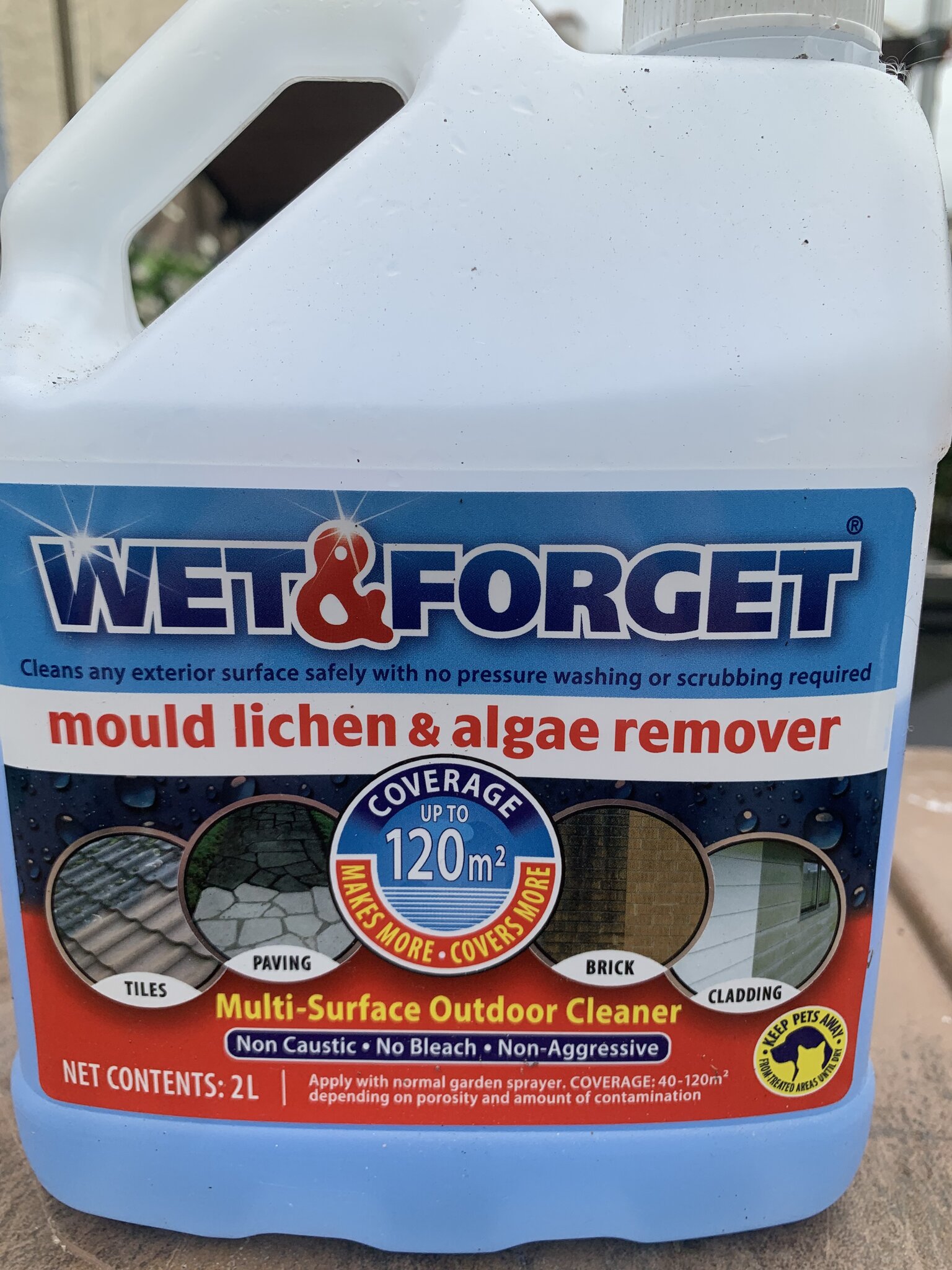

I’ve used fairy liquid, car shampoo, fenwicks caravan cleaner, fenwicks awning cleaner, dettox mould and mildew remover, stardrops, you name it, I’ve tried it.
Nothing seems to bring heavily stained marks off. They all clean surface dirt off but I’ve yet to get stains out. And no sooner have I washed it, wind picks up and blows sand or dirt back on. I must admit I’ve not tried neat bleach but worried it may discolour the coloured parts as mine is blue stripes on a white background.
Unless it’s ’locked In’ which some products can do give this a try it does remove stubborn stains.
