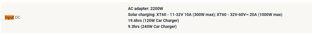

I know but this may help you and Mr Vanbitz son. The 757 has a charge rate through the solar / 12v xt60 port of max 300 watts at 11-30 v, (unlike the 767 which will take 20 amps at 33 volts). Think the only way to get faster charging thank you are getting is via the ac input from an inverter. Good luck
Input:
AC Input Voltage: 100-120V~ 12A Max, 50Hz/60Hz
AC Input Power (Charging): 1000W Max
AC Input Power (Bypass Mode): 1440W Max
Solar Panel Input: 11-30V 10A (300W Max)

If you use an XT60 plug into the port that will (allegedly) accept 300w why wouldn’t it accept 300 watts at 12 volt from a dc charge source?
I guess it should 🤔
