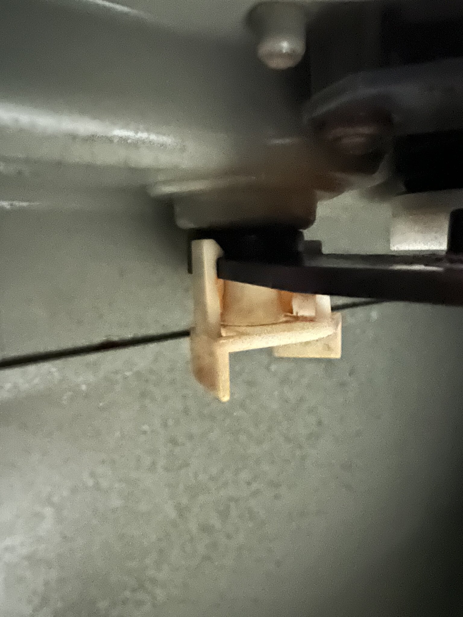

Dismantled my C200 Thetford cassette, added lots of citric acid in warm water and soaked everything inside the main body.
Lubed and reassembled and nice and shiny clean for another year.
I took some photos and a video to aid the task when assembling inside.
I also discovered that the level sensor float was still in place, but wouldn’t float due to scale. Citric acid descaled it nicely so floats once again.
This is the blade mechanism retainer:
The float that I thought was lost.
Shiny inside.
Ready for assembly.
