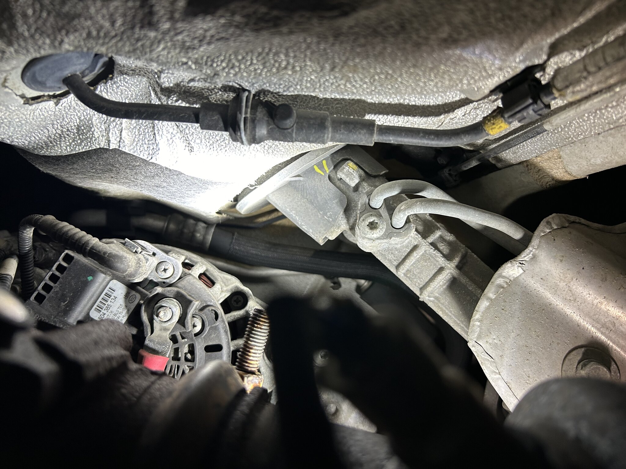

Any idea what size alternator you have? I’ve tried looking but seems impossible to get to.
If it’s a Fiat, crawl underneath behind the front wheel on right hand side.
You will see the alternator by the bulkhead behind the engine on the right hand side.
Stick a phone camera up on timer and take a picture with flash. My label was obvious on a Fiat Ducato 2013.
Yep, don’t it. Not easy on a gravel drive🤬
220 amp.
Thanks
