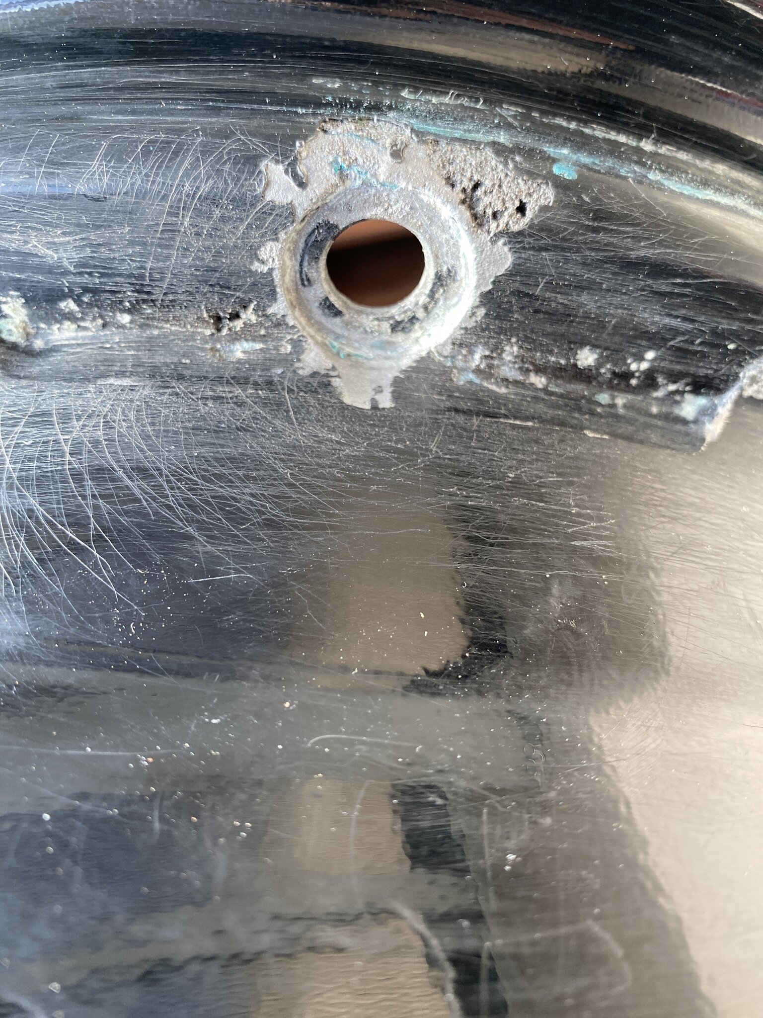

When I bought my new van the dealer offered to put some sort "slime' in the wheels to help in case of puncture. I forgot the name. 4 years later my alloy wheels started leaking due to corrosion by the 'slime' around the brass valves and the alloy. I had to replace 3 wheels. Not nice...

good to read your now sorted, i dont think i missed this in the thread but, Tyre wall punctures are a tyre write-off! no amount of any type of goo would fix a tyre wall puncture even short term, and it should not be repaired with a plug.
I thought that too and shoved the goo in anyway, it worked and got me home to the spare tyre. I have no idea how it worked, but it did, was a hole caused by a pothole as well so even worse but it sealed.
