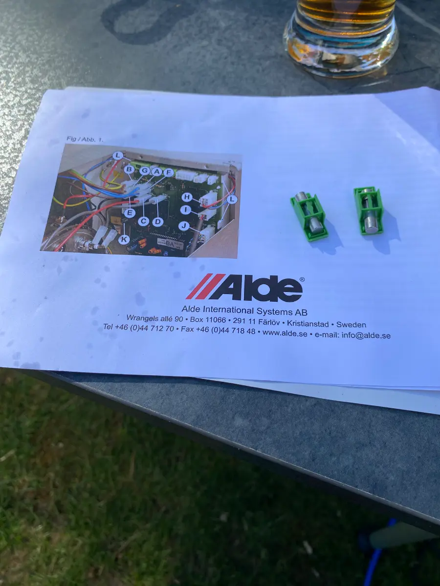

Another nice touch, technician gave me back 2 removable fuses from our old board, saying now you have them you won’t need them 🤔👍 but as a colleague used to say I would rather be looking at them than for them justifying carrying every possible spare he might need
