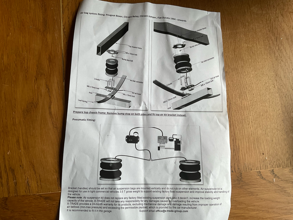

.the air bags when fitted . The axial was then rated at 2000 kg. That’s the axial .
you don’t remove the leaf spring to do this.
this video will show and help you .
i tried to download a link but your have to search you tube for this.
Copy and paste this into YouTube.
Installing air suspension on a Citroen Relay / Boxer / Ducato / Pro Master.
