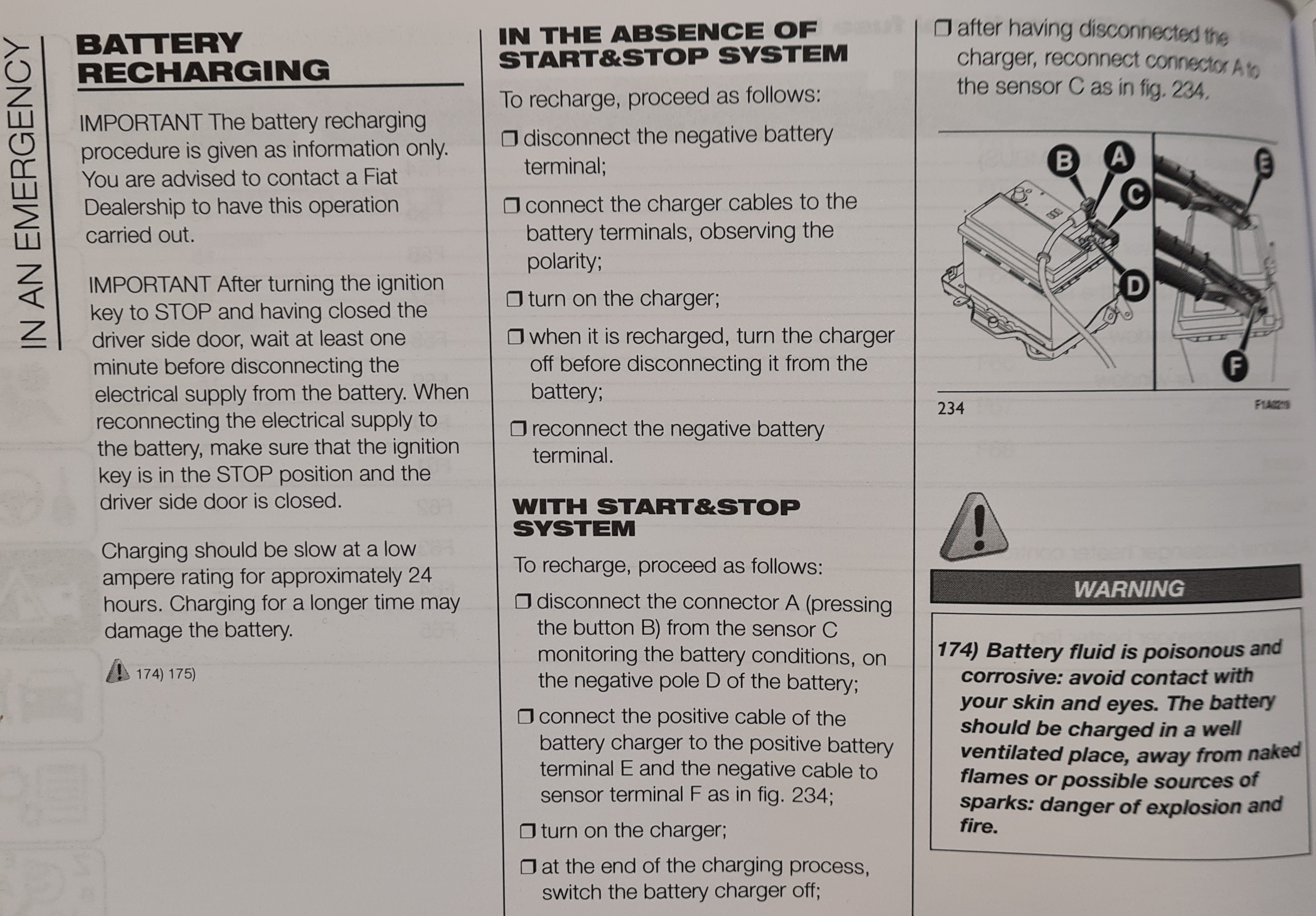

Hi, just put this page from the service book here in case it might help someone, it's for the Fiat x250 2017:
