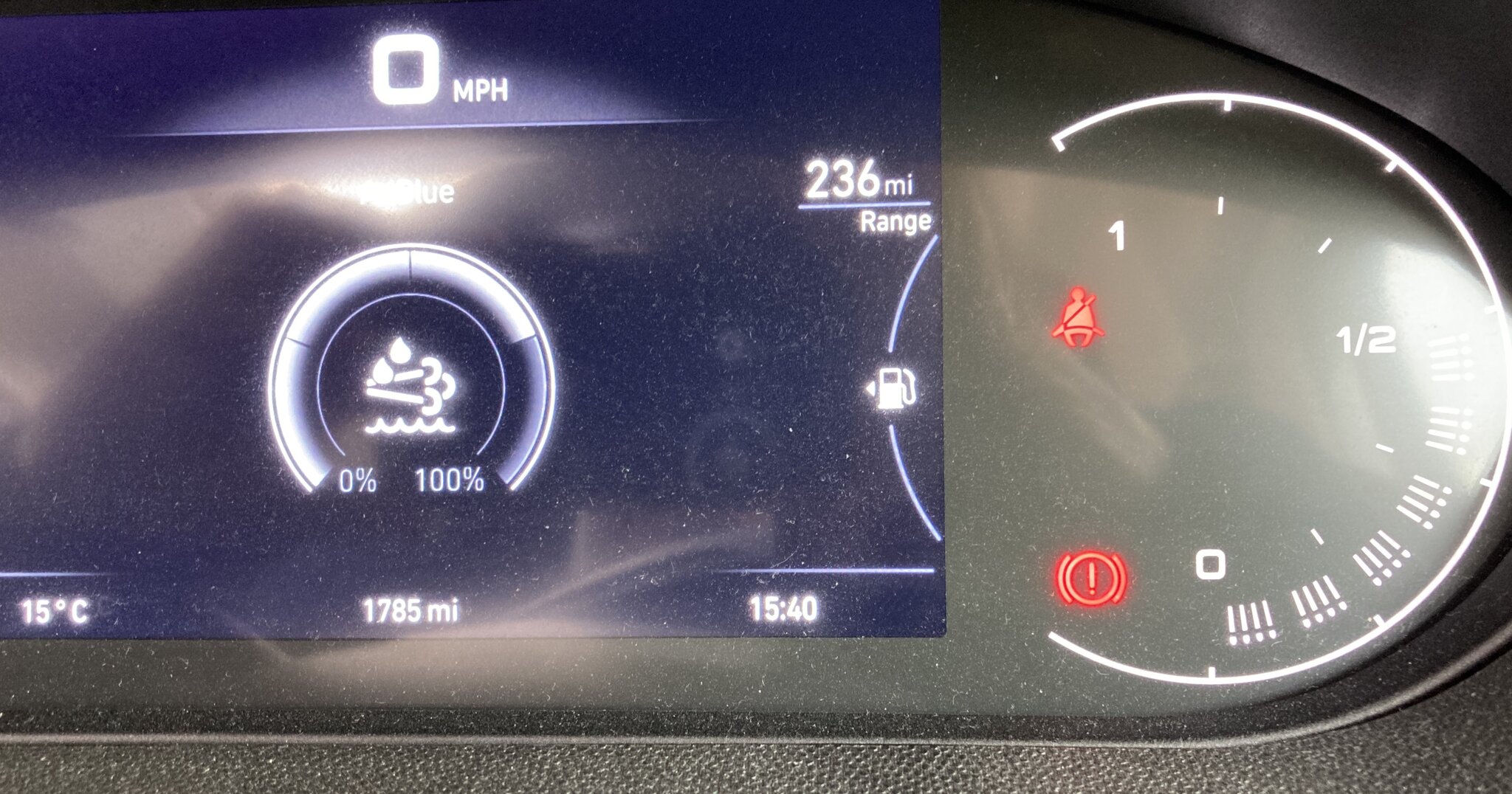

Hi All
Our Fiat van is the first vehicle we have owned that requires Adblue. It has covered 1,800 miles in the past 15 months. A few days ago I checked the Ablue level indicator on the 'digital dashboard' display and it's about three quarters full - picture below. I understand that the capacity of the Adlue tank is 19 litres, so it seems that I need 4 to 5 litres to top up. So, on impulse, I bought a 4 litre container of Redex Adblue from my local supermarket. The container supplied with a small push-on angled spout, which is claimed to prevent spillages when topping up with Adblue.
I've been reading Adblue threads on this forum, but I still have some questions:
1. The FIAT and other websites state that I should wait until the Adlbue warning light comes on, and then I should top up with at least 5 litres. Is there any reason why I cannot top up more regularly with smaller quantities? BTW - The handbook doesn't mention a minimum quantity.
2. I fitted the supplied spout to the Adblue filler pipe on the van. It's quite short, and I assume it doesn't penetrate far enough to open the valve inside. Even 4 litres is heavy to lift up; I don't have a steady hand, and I can't see how I can poke the spout into the filler pipe without spilling Adblue all over the place. And - as for quickly removing the spout to avoid spillages when I've topped the tank - I don't think so!! ... So would filling via a funnel with a long flexible pipe be good enough, or should I buy one of those filling contraptions LINK available online?
Thanks in advance
Les

Just filled up the van with ad blue
4600 since last topped up and it’s took 8.3 litres at the pump. That means it was still about half full.
Quick and clean, no mess.

One basic question, is it ok to use the HGV ad blue pump? As read somewhere the flow rate is higher, is this a myth, or is it something to be wary of?
THANKS
I've never understood why anyone would purchase AdBlue from a forecourt when pretty much every motorway service station has them on pump, particularly as this is one of the very few things that are actually cheaper from a motorway service station than a normal garage, and ten times more convenient.
It’s probably because most people would not want use a Motorway forecourt ( because of the ridiculous fuel prices) so would not know that the Adblue may be cheaper 🥴. I am not sure that having to go onto a motorway to find Adblue is also very convenient 🤪🤪
