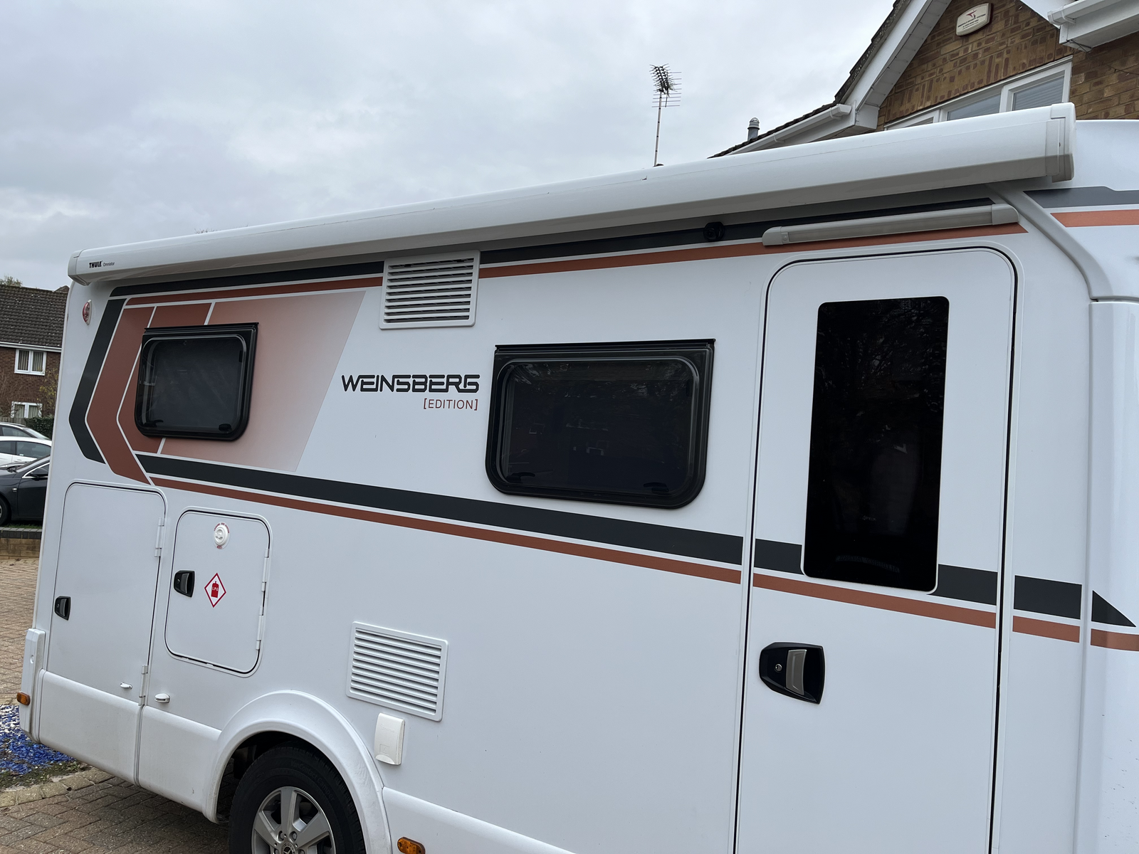

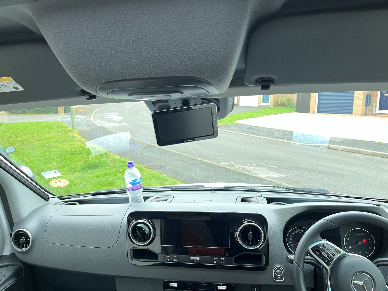

We discussed position and colour of cameras, going for the black ones all round with Kes, fitting them on the graphic line to blend in. The rear below the factory reverse camera. The front in the MB Star similar to OEM position on our GLE. We decided on the 7" screen as the 10" in the Sprinter cab was just too big. We had it fitted using the windscreen mount that is in place but not used on the Sprinter Tractor Head our MH is built on. There was no issue with the Remis blinds as they don't go over the OEM binnacle that houses various sensors and cameras for driving aids. This option may not be available on other base vehicle configurations. Placing it on the dash centre or driver side as lots on Fiat base vehicles do, wasn't suitable for our use. We can both see and use the screen from our cab seats.
Dean does the software and graphics work. We specifically wanted markers on the screen graphics to show the position of the waste outlet, the gas inlet and the position of each of the M-Level rams in order we can ensure we don't deploy on unsuitable ground as our 'pitch' at home we had built for our previous caravan that now hosts Velma the Weinsberg with 2 rams deployed. Dean also models the roof furniture ie satellite dish, solar panel, skylights. He also put a 'Weinsberg' graphic across the roof image. Together with our orange logo of a scene we have on the rear of the MH.
The power switch that gives options of ignition supply, off and leisure battery is mounted in a false hole in the MB Sprinter dashboard. The leisure battery option allows the camera system to be operated when away from the MH and together with a 128Mb SD card loop records all 4 cameras for 15 hours, then continues. The screen can be put in dark mode so not showing all the time. There is a remote control that can be used as well as buttons on the side of the screen.
There is a multi use switch in the dashboard that allows switching through the various modes, that can be specified or left on default. We chose to leave as is, so forward, reverse, left, right and bird eye view can be scrolled through. Also the system is set such that operating indicator will bring up up view of side/top down on that side, if hazards put on all 4 direction views plus overhead. Reverse has guide lens at 0.5, 1.5 and 2.5m distance.
