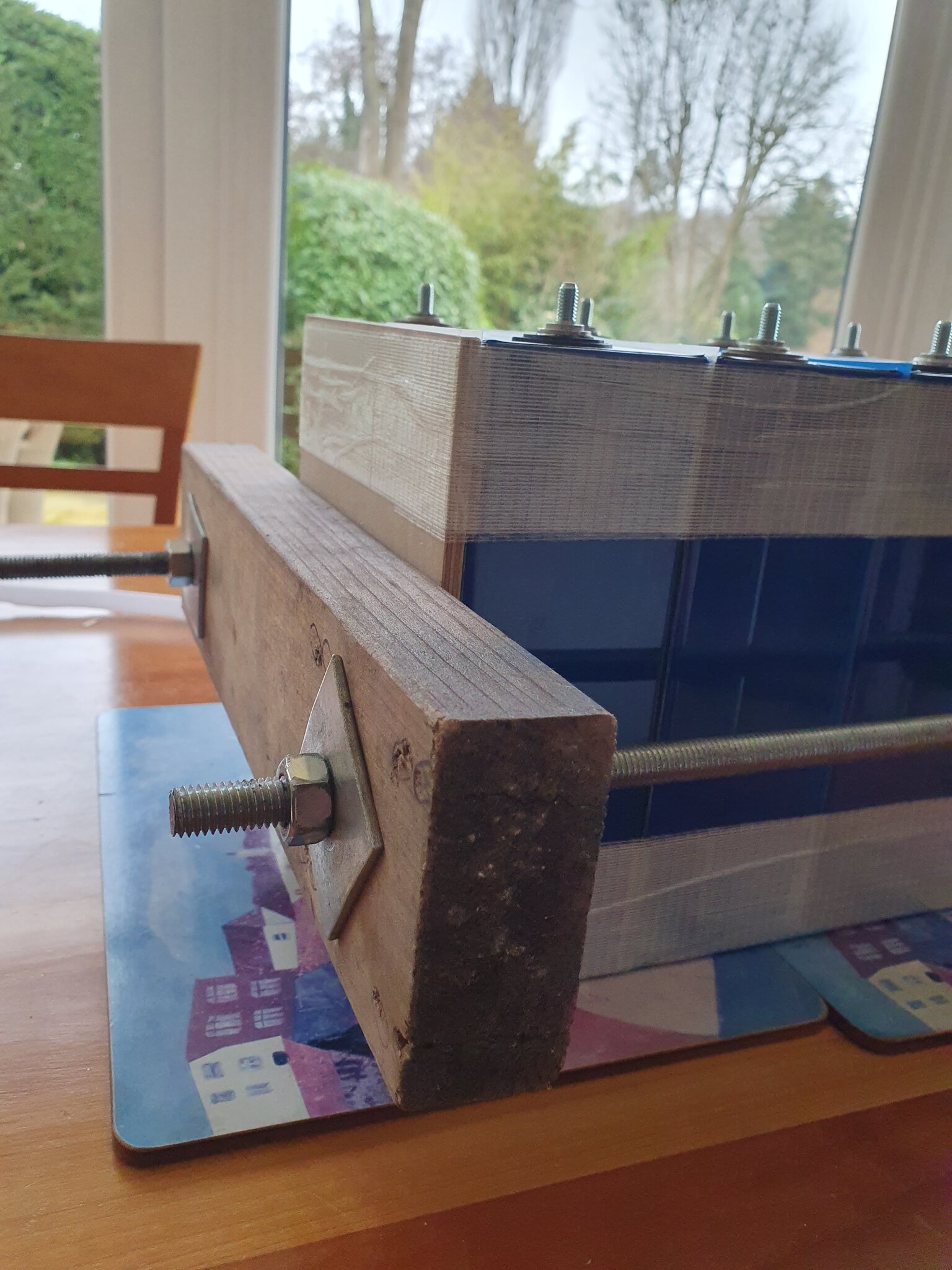

Hi David,Out of interest did you compress the batteries or decided it was not required? I spent hours of research, did compress mine but I am still not sure if I needed to?
Thanks.Neat solution.
Again, clever. Maybe I overthought mineIn my case I built the ply box very tight, allowing a space for 1.5mm fibre board separator for each cell. Two fibre boards on the ends, so it has 3mm ish compression on a stack of 8 cells. At first full charge, I will take note if the plywood box will bulge out on the ends. At the moment they are not charged and quite snug, cells will not move if I tip the box on its side. I tend to agree that a restrain it’s better than compression, unless you can apply a even 12psi pressure. I have seen the way seplos build theirs, and they do not compress but restrain. Similar results are achieved with fibre tape.
I do not compress the cells in my battery packs as certainly the manufacturer of my cells does not indicate or state that the cells need to be compressed.
SeanF1 on what basis did you compress your cells, did the manufacturer of your cells advise this or was it because of those that promote the practice of doing so on Youtube?
I like Raul restain mine by binding the battery pack together, but I use Kapton tape as does Will Prowse.
I am using eve cells and they recommend using 300kgf compression in their datasheet. I followed the Fibre Tape method used by Offgrid Power Solutions on YouTube as their approach made sense to me
