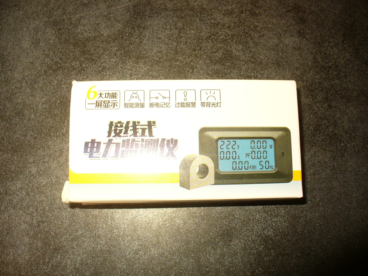

Is there a way to find out what current my van draws?
YES, I will take some piccies later of a unit I've installed in ours so that the wife can easily see what she plugging in
this is the unit I've installed, it just goes in line with your supply, just after the plug/socket to get the usage reading, incidentally I brought it from ebay, the biggest problem is mounting it (finding somewhere) wiring it is a doddle, good luck, been installed for a couple of years now, sorry about the reflective flash from the camera
