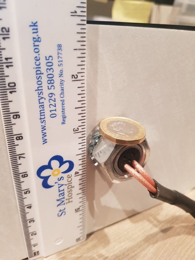

hi TinTentTourist looks good. and i am very interested. do you have a photo og the underside of the antenna unit please? so i have a reasonable idea of the protrusion on the underside.

Phill D I hope this pic helps, with a £ coin for scale :)
