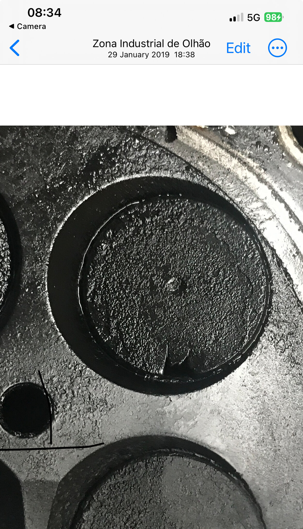

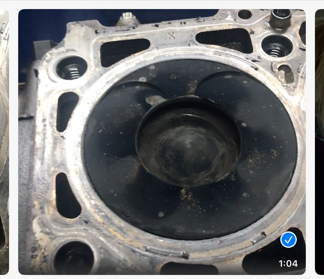

Well I don’t want to worry you but I had exactly the same problem with my No 5 glow plug not working and inaccessible to remove on A class Without the complete engine being removed !!!!!!
I went a couple of years with the problem and spending over £3000 with Mercedes trying to discover the problem of rough tickover and slight smoking but always passed the emissions on mot
I think they knew the problem but said could not find fault as they knew engine had to come out just to get at the glue plug !!!!!
Anyway I was in Portugal and near a motorhome garage and asked them to have a look and straight away the master mechanic (old boy) NOT a new type technician!!!! Said it was glow plug problem and engine had to come out to get to it !!!
Well I eventually agreed as wanted problem solved and in the end it cost me over £8000!!!!!! For new head valves and other stuff that I renewed whilst engine out like pulleys and the glow plug brain that was also part of problem, but overall the glow plug had disintegrated at the end and tiny bits damaged the valves and to much diesel getting through !!!!!!! See pics !!!!
Also led to new turbo following year because of all the bits getting through to turbo and another £1600 !!!!!!!
