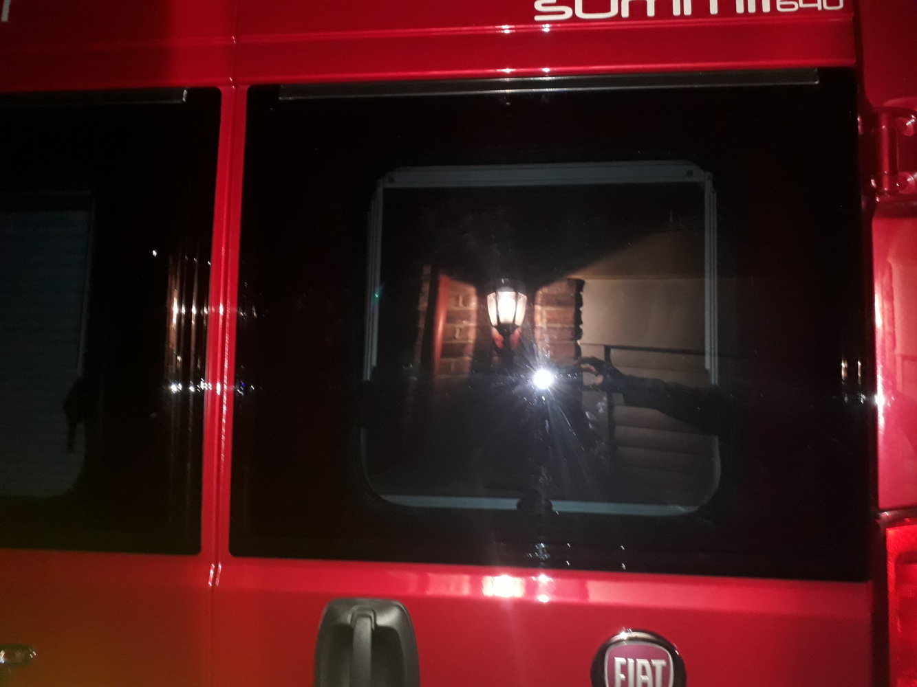

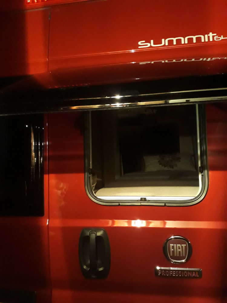

A bit of advice needed please,
I'm not sure if any other PVC owner has this problem but it appears that my rear doors can't open fully to the bump stop position as if they do (In wind etc), then the van body will smash the window plastic.
I hope the pic below is clear enough but if you notice the bump stump (lower bumper) is actually a good distance away from the door when the window is touching the van body (just above the light cluster).
This is not a good design so I wonder if Globecar will change the windows as this layout is not exactly fit for purpose IMO.
Has anyone else experienced this problem as I'm sure that this window style comes with the standard Campscout vans besides others.
TIA,
Andrew
The doors on our 2013 Ducato (not a Globecar) can only open to 90° as there is a metal link to stop them going any further. The black plastic thing below it in the picture is a conduit for electric cables.
I assume this either has been removed or perhaps no longer fitted for some reason on Globecars?

We have a retainer that stops the doors going back too far (Citroen Jumper/Relay 2018) but that can be released - seems pretty strong so wind shouldn't force it back but extended stopper would give option to open the doors back further if required.

Our Campscout also has the metal link which stops the doors at 90 degrees but this can be released using the black push button on the door as shown in your photo.

My 2013 Pilote rear doors open beyond 90degrees by pressing the black button in door panel.
If you get a good gust of wind that’s forces the door out of your hand it will bend the bar.

I've just popped out to take a couple of pics and you can see the difference in size between the window apperture and the actual window unit itself; a huge difference.
One advantage of the larger window 'glass' is that if it's raining and you want the window open it stops rain getting in at the sides, also similarly if you cover the 'glass' when open in sunny weather, you get more of a sun shade than the 'same size as hole' ones.

Some really good points there Mel :xThumb: I've had a look at the bump stop and it should be easy to extend them by an inch or so.
The large blacked-out windows against the maroon paintwork do look good though.

We like the flush windows that you get with the EP versions but they out of proprtion/too small for the campers, especially on the rear doors.
I'm not worrying about extending the bump stops on ours as I sometimes open the rear doors 180 degrees when at home if I need them out of the way, but other than that its usually just 90 degrees so not likely to do it when away especially since when opened 180 degrees they don't have a 'fixed' retraint and would likely swing round and smack me or cause damage if the wind caught them.

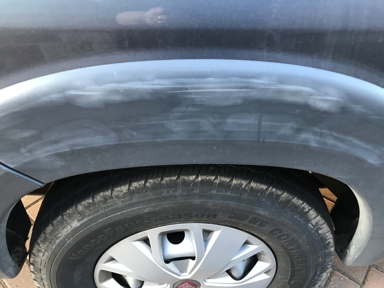

We love our Campscout Revolution but have a couple of questions which we hope you can answer.
Ours is the 2015 model, which has the decals around the top, most of them are plain grey and they are fading. We have noticed that newer models don’t have all these decals, how easy is it to remove them and has anyone tried and succeeded?
The plastic wheel bumper has some scratches, how easy is it to remove them and does anyone know of a product which will bring the plastic back to condition.

If you want to save a whole load of money then buy a cheap plastic panel (with deep scratches) from the scrap yard for a couple of quid.
You then need to sand the affected area using wet n' dry sandpaper before applying direct heat to make the area lightly tacky before massaging the scratch out.
Be careful not to burn the plastic though. Before it starts going cold then apply the bumper conditioner as what John has mentioned above.
Polish off and reapply a second and third coat as appropriate.
......then take a deep breath and try it on your van :D

Bumper coating and tyre shine will help with the plastics but it will need re-applying, however its not difficult to do and will be the cheapest option by far - I think B&M or Home Bargains sell it for £1 a tin.

Has anybody used T cut bumper care?
I've not had any experience of it myself but IMO I would opt for John's @Neckender idea above; i.e. keep it simple.
The product application process in the video looks easy enough but the guy makes bold claims about the longevity of the material and that's where I would be a bit sceptical.
EDIT: I don't know if such a treatment will cover any deep'ish scratches.

We are going to take the good advice and use wet and dry to try and remove the scratches and then buff the plastic. Hopefully if we do a good job we might not need the T cut, but it’s a good fall back if the colour has faded.

It would be good if you could practice on a hard piece of dimpled plastic first so that you can get a feel for the materials being used.
I would recommend that you sand very gently in the same direction as the scratch but try to avoid sanding much of the surrounding area as you don't want to errode the dimpled surface of the bumper.
......then get your hair dryer with a directional diffuser and apply heat carefully and in theory you should be able to massage out more of the imperfections. Don't apply the heat for too long but you'll know when to remove it
