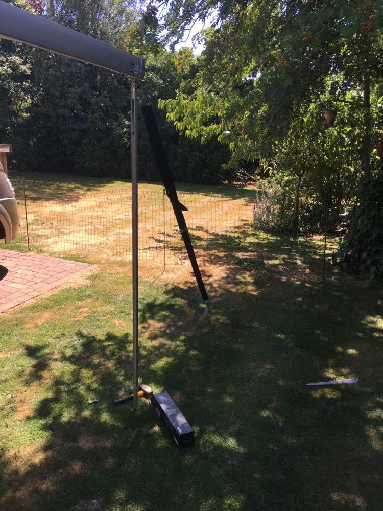

Peter is so right, just been doing a hand over with Bev who is borrowing my MH next weekend :)
The T piece I think is still as always was as mentioned Fiamma I think have the hook connector
So back to tutorial with Bev, she wanted to check she knows how the awning comes out so I let her do it while I monitored
Bev couldn’t get the pole in let alone out
I have now realised that I always stand to the right of the winder fitting, effectively under the awning as it comes out. Bev was trying from the left which may have hindered
We now have it in and start to unwind, luckily it did as we have been warned what often does particularly on the longer awnings. The far end didn’t come out of the case. Wound it in again and restarted still the same but good old third time lucky out it popped
But then again we spotted as we had been warned if the release isn’t clean it will then not come out square which it didn’t. So did as told wound back to case, not right home , just up to it, the go again all now straight and correct :)(y)
Also got the tie down kit to see how that works, due to Bev’s involvement I read the rules and was very surprised to see they suggest pegging it square to the leg rather than the 45degree option I would have used
Clever fittings connect to leg then a sprung loaded strap connects to a reasonably meaty spike
Back to pole removal (which already sounds a little oe’er vicar and worse spell chucker changes pole to poke :LOL:
If not at the right angle which is probably greater than you think it does not come out easily, I have also noticed that on mine the fixings for the end piece oppose the adaptor, so when turned across the opening the pole will release
As above it will never come out, at least means you can leave while doing other things and it won’t drop out (y)
Lift out to nearly 45 degrees which is actually in line with the fitting,
turn till in line with slot and out it pops, I can now do it one handed :)(y)
Hope this helps (y)
