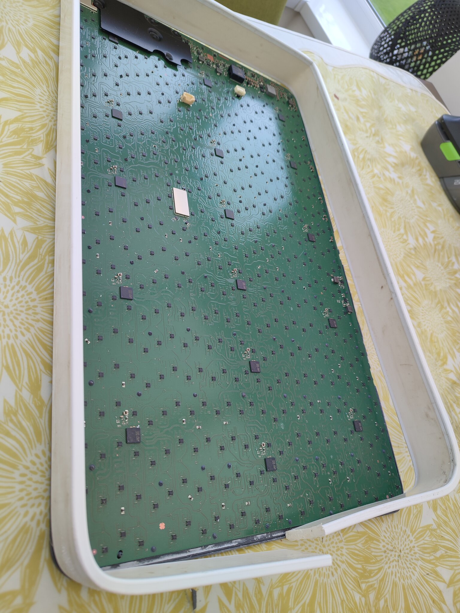

It's been raining today, so started the next phase of modding my starlink, next stage will be to make a casing, which I am hoping will be very slim and then do the full modification to turn into purely 12v, by removing the 48v requirements. So long as the supply doesn't exceed 16v or go below 10v then I shouldn't even need the stabilised 12v supply.
Got some more bits arriving tomorrow, so will start doing the techy soldering stuff on Monday probably

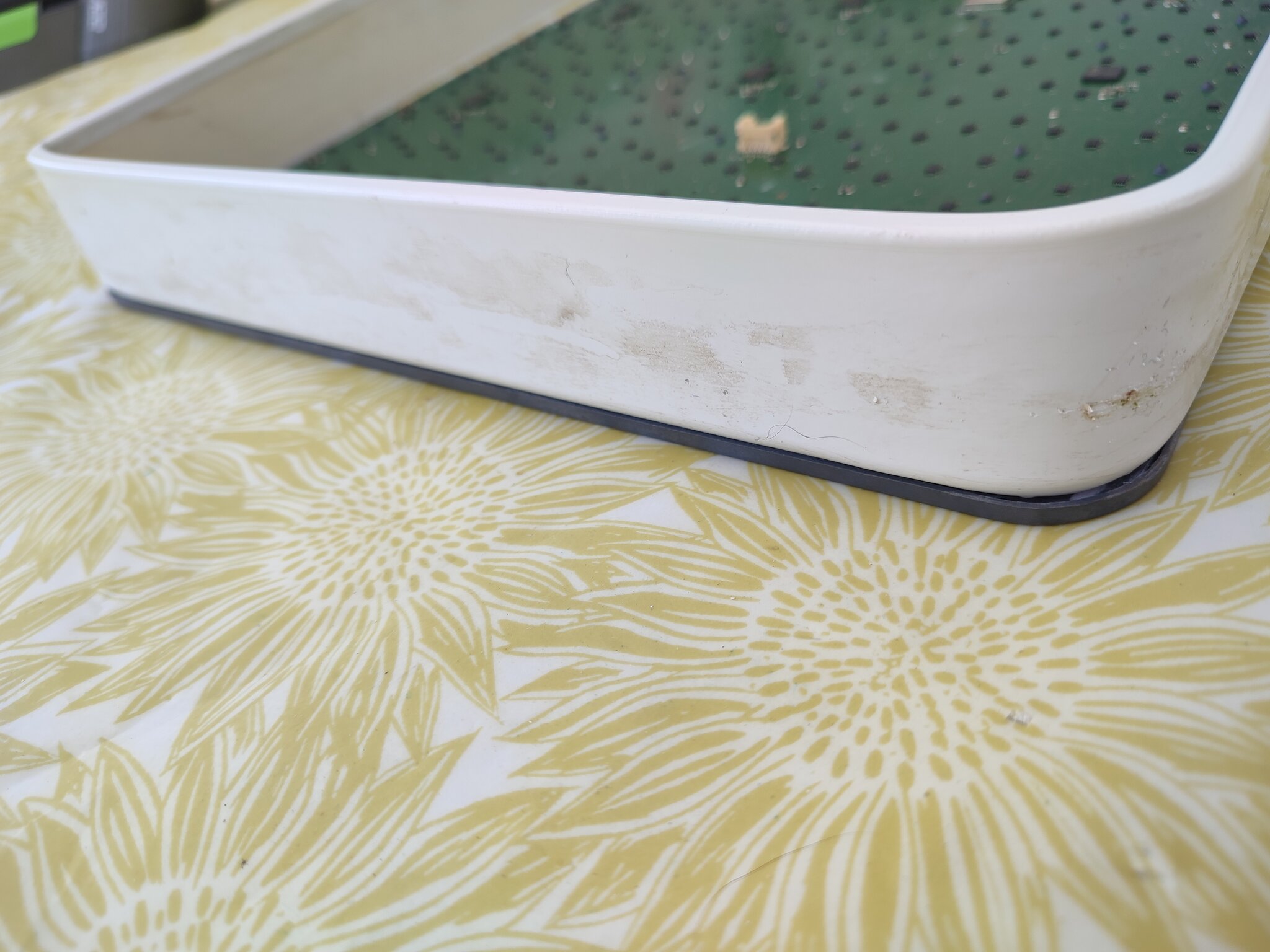

And the first attempt at the frame/shroud made from a piece of uPVC trim I had hanging around. I will use a smaller piece when I redo it. This is 45mm, so I will look to use @25mm as the starlink is only about 12mm in height.
If it works it's a pretty cheap and effective frame.
I will sikafkex the frame to the starlink around and in the groove left from the original shroud, you can see the groove on the third photo

Update - used 25mm uPVC and it's a lot easier to manipulate. If I were making a few of these I would make a template, it only takes about ten minutes being without a template but I suspect it would be a lot faster and neater with a template...
I will just use a thin plastic sheet as the cover to prevent water ingress when mounted.
To be honest, it's that thin/slim I might not even permanent mount it. It takes about as much room as a 20 inch TV now that all the original shroud has been removed. Fie those who don't want to go down the expense if the 12v conversion, it can just be used as it is now, using all the original cables!
Probably a few sucky connections at each corner and it's easily mounted and the low profile should stop winds for displacing it ...
UPDATE ...
Not the prettiest jig/proforma but the frame fits the starlink perfectly. Took me 5 mins to make a frame - could have been quicker if I had more clamps .....
Who's brave enough to make their own at the Thorpe rally ...... I can bring the jig with me ?

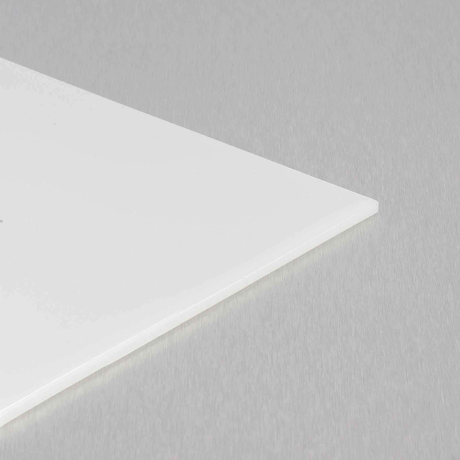

Just wondering have you considered HDPE. I am working with it at the moment and it seems very easy to work with and pretty cheap?
Easy to weld, join and bend.

MisterB Shame you are not nearer. You could have popped over and had a go with my plastic welding kit on some hdpe to see which you preferred.

Gromett - great suggestion - where is 'nearer' ..- i reckon ..that would be a much better looking/proffesionla process than me just bending some upvc trim with a hot air gun! I reckon i could get it looking rally neat but it would be so much better with a welded joint. im always up for a peoject ....!
does it comes in strip or all sheets? easy to cut and finish?
is it one of those stapler type welding guns or an extrusion type plastic welder?

Have a look at the link I sent. It comes in many sizes up to 2m x 3m and they will cut to size if you need it. Not sure what thickness you want but for example 1m x 200mm in 2mm is less than £2.
I do not know the dimensions of dishy off the top of my head and I am not unpacking mine to find out when yours is already on the bench :p
VERY easy to cut, shape and bend. If you cut a 20mm strip for instance bending would be trivial.
Welding the sheet to the curved bit would be straight forward as well and would ensure a water proof joint.
You could go even further and route in a groove and install 'O' ring chord. Then use inserts to screw the lid in. Probably going a bit far but lots you can do.
HDPE, love the material! ✔️
You mention bond… I’ve tried lots of different ways of bonding, all failed. Plastic welding would work for the join, but not sure if plastic welding to the dish would work?

not in any rush to be honest, but once ive stuck this in, it wont be coming out again. i may have a go at making a template though .....
