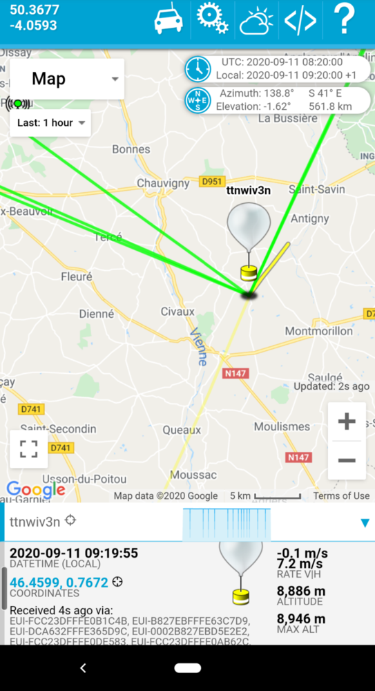

It's alive I think. Its just transmitted some data but all zeros probably because the gps doesn't have enough power to get a fix.
The message at the top appeared just as I was taking the screenshot. Its from the guy who wrote a critical part of the software and who is monitoring progress of the little balloon. :)
