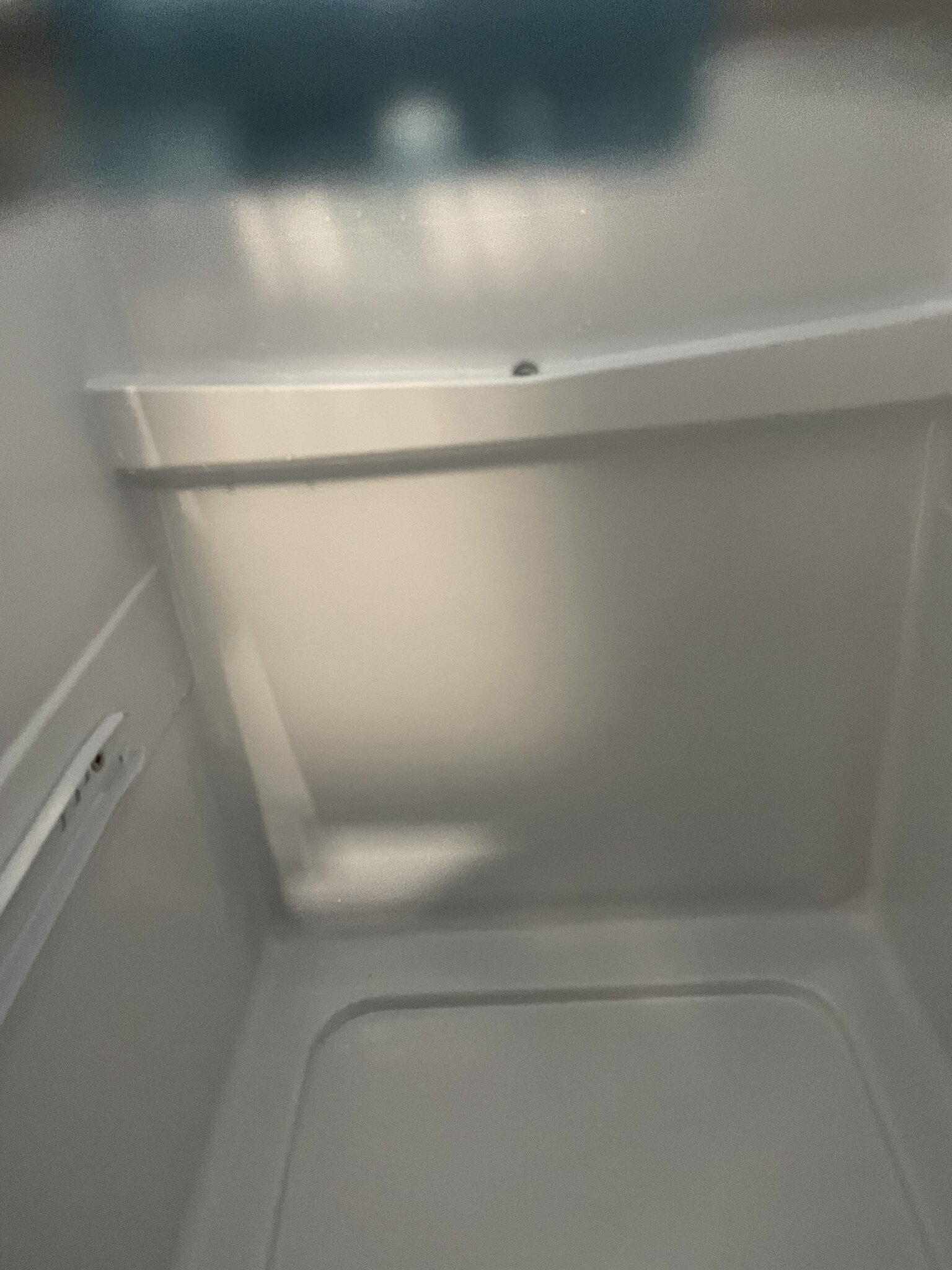

Hello
Day 1 of new thetford compressor fridge (Adria twin).
As well as usual ‘hum’ there is this strange ‘scrunching’ noise on left side, mid fridge.
Also seems to be present when other ‘hum’ presumably the compressor, turns off, but then stops after about 15s as well.
Any suggestions?
Hope it can be heard in video.

Which model Thetford and does it have the drain tube attached or rely on the internal drip tray instead?

Thetford T2138, looks like a wee drip tray at the bottom.
The noise definitely continues after fridge turned off, so I don’t think it’s the fan.

It’s a front opening door, freezer at the top.
When fridge turned off, it gets quieter for a bit and then eventually seems to stop.

The timing of the noise is spot on for refrigerant flowing through, if you can hear it, it usually stops a few seconds after the compressor stops. But it doesn't sound like any refrigerant I've heard, sounds like a paper label catching the condenser fan round the back 🤔

We have an Adria Twin with the compressor fridge. It gurgles and sometimes sounds like a dog lapping water. I understand that these noises are from the refrigerant gassing in the coils - as it is supposed to. We have got used to the noise!

I have the same van and the same fridge as you. I have also the same gurgling sound.
I sleep in the fridge side and know very well the cycle😆
After the compressor stops, then the fan stays on for a while, with that gurgling in the background, then everything stops a few minutes untill the compressor fires again.
So, I'd say there's nothing wrong with your fridge.
