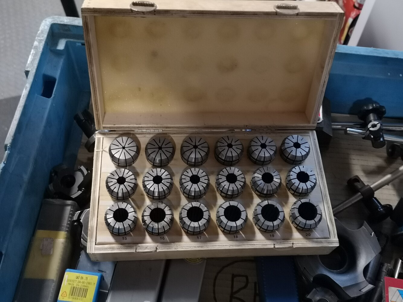

Nice looking collet set. I have been tempted to buy some collets for my inherited mini lathe or the mill but I am very wary about how accurate they would be fitted on a cheaper made lathe. I have heard a lot of people struggle with inaccurate collets.

I think I might turn up a small chuck to mount straight onto the Myford spindle so it will have a through hole and minimal overhang. Got a short piece of 2" dia EN8 that will oil harden ok, watch this space !
if I remember correctly when I got a set of er32 collets I got one holder with a mt3 taper for the mill and then just machined up a holder for the lathe.. the closing rings can be bought separately so its just the holder you have to make..

The holder on the left in the photo was machined to fit the myford lathe spindle and take the er32 collets..
As i said above I bought the closing ring as machining that wasn't just so straight fwd..

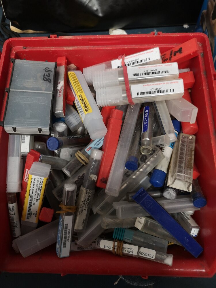

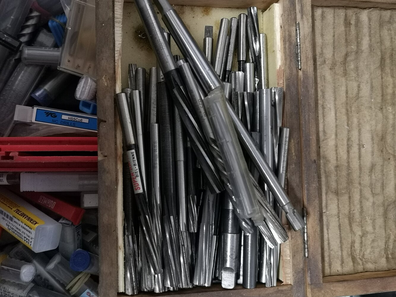

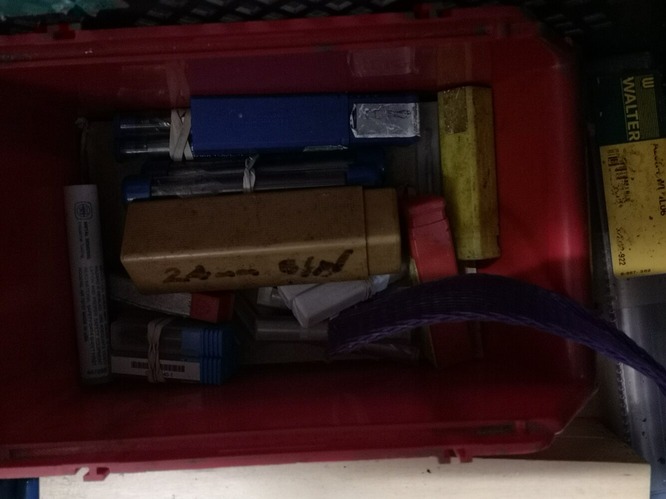

If anybody is short of any tooling I have a load for sale all quality brands, finished machining now so have a wide range of gear, measuring, bore gauges mics etc just a few pics of stuff for sale just pm me and I will let you know if I have it.
Was intending to put it on ebay but never getting round to it.

What a fantastic collection. I'd love a rummage, but unfortunately I couldn't be further away from you!
This sales/wanted site is well used by us model engineers and is free.
