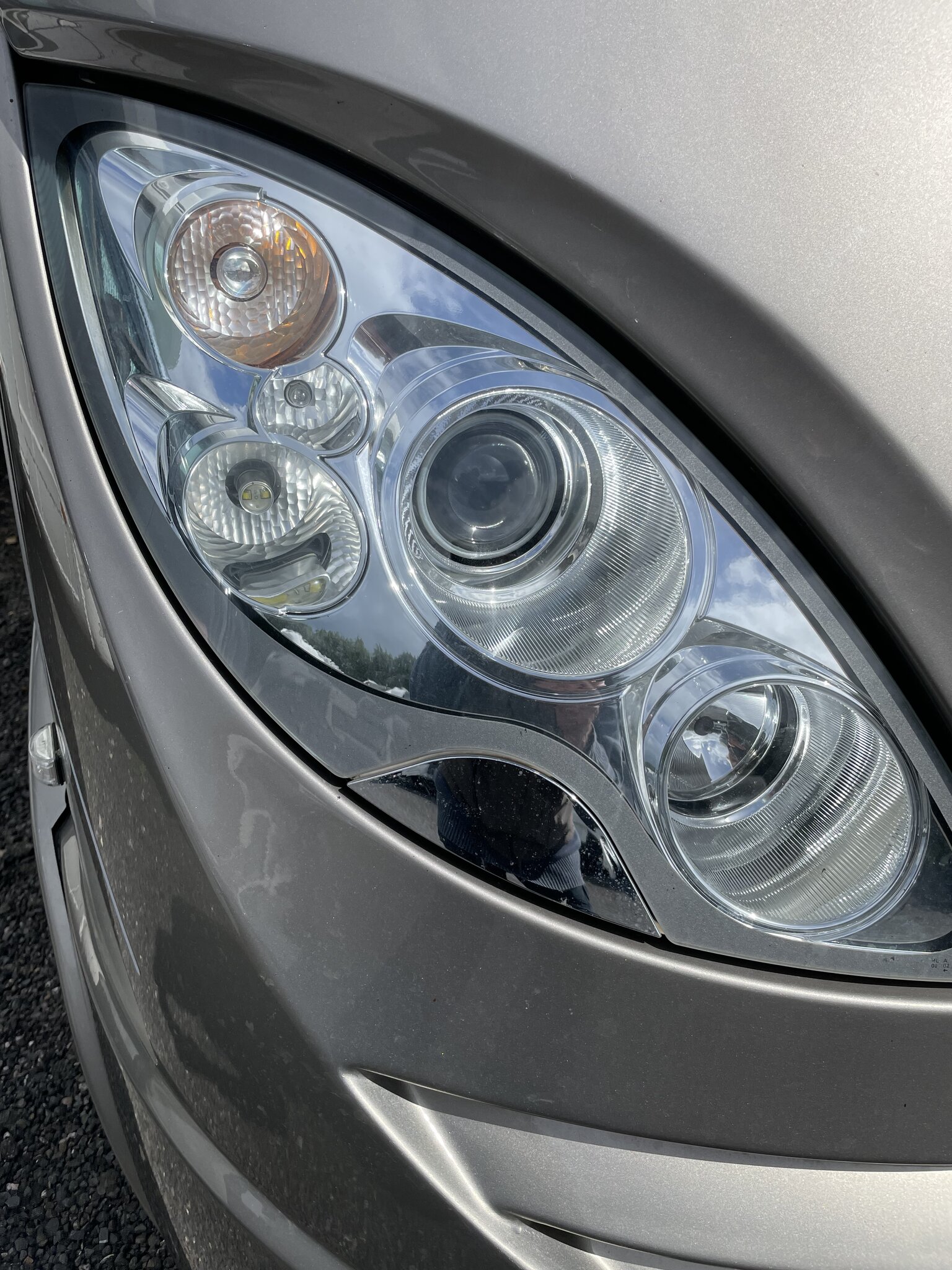

The sealed units can be disassembled with hot air and a lot of luck. A good hot air gun heats the glue till it can be separated. Then clean the glue off. Resilver the reflector. Polish the inside of the glass and reassemble with new mastic type glue
It would be worth a go what's the worse that could happen

As you've ordered one, why not remove the old one and see if you can cut away part of the outer casing to get into the headlight and see if you can make some sort of repair. Or even cut the casing an inch or two from the front lense all the way round, leaving enough to make a repair. It won't hurt having a go .......
At that price i would of certainly had a go.

worst that happens on that awful design is the glass lets go and becomes a jigsaw puzzle of 6mm cubes

The projector part is the dipped beam, which is above the main beam light (see below). This is a standard H7 bulb/reflector. The cover is glass not perspex and apparently prone to damage from stones. I am between a rock and a hard place at present. Unit ordered from Germany and not drivable until it is fitted by the garage and retested. I will see what is separable when I get it back and post pictures because you never know, next year it may be the nearside that is a problem.

Just what I thought. Looks perfect to me.
I would try a different testing place.
Problem is I guess its already failed so will be on record somewhere so new garage would be looking closely at it?

We’ve had our 2014 B544 since it was a year old and they’ve always looked like that, the upper one being a ’cloudy’ appearance.
Are you sure it’s not just the MOT place that are not familiar with this type of headlight.

I have an Exsis i with the multiple light bulbs. My local garage has just failed my MOT as the offside projector lens is cloudy and emits very little light. They have always been dim but even with upgraded night breaker bulbs, they are useless. Does anyone know if the projector unit can be removed and cleaned or replaced replaced at a reasonable price?

The bad news is the garage not possible to separate the projector unit from the headlight. So it is a complete new headlight. Just ordered one from Brownhills £2152. Going for a lie down after a glass of wine
Man I am sorry to hear you are getting ripped off at that price, just a thought but I used to get day time MOT’s for my bikes, could you not get one off them done and then wait and see if a replacement unit turns up.
