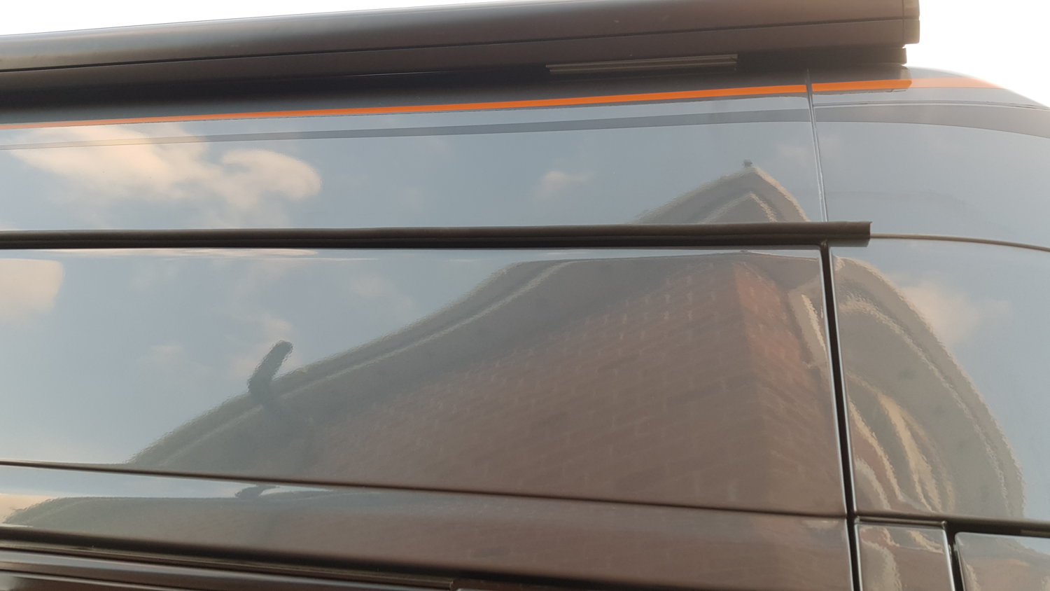

Im thinking about making an over sliding door gutter and strip light, dont want to pay over £150 for the dometic.
Im also thinking of adding further outside lighting, maybe in the void over or under the sliding door
Would something like this do for the rain channel Jez?

@jezport looks good - is that the stuff I found on Ebay? If so I might get some too!
jezport
Oct 29, 2008
5,092
6,013
West Yorkshire
4,712
PVC
since 2008
Yes, but by this morning an end was hanging off. Have put back on but it may need sikaflexing on. Its an arse of a job as its flexible rubber. When it arrived it was rolled up, so I had to leave it puilled out straight on the table a few days before fitting.
Will let you know how it goes.
