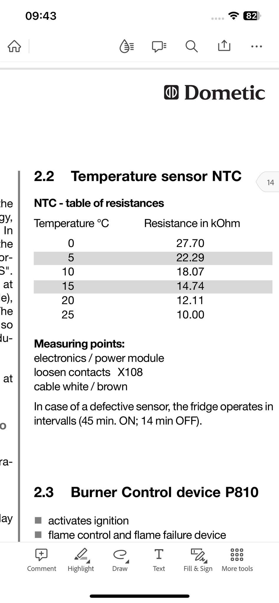

Check the thermistor is located correctly , there should also be a reference resistance for any given temperature , many Dometic docs online.

Thanks again. What's a thermistor? Excuse my ignorance? Waiting for new burner ignition, but can't get gas to light manually, although it worked at dealers on Friday. Plenty of gas & yes it's turned on.

It's a temperature sensor for an electronic controller.
The old mechanical thermostats have a silvery capillary tube called a phial. 👍
