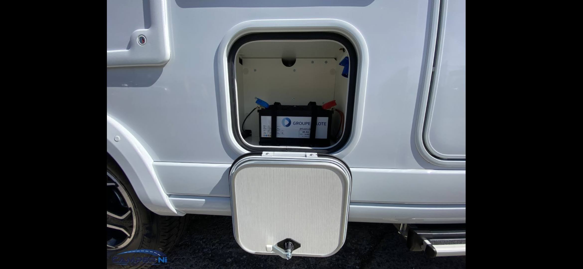

If anyone else reads this looking for measurements. I measured it as 52cm wide x 43cm depth (front to back) x 44cm height. Remember that there is a hatch (front right) to allow the electric hookup cable into the battery box so some of that depth measurement may be limited.
Pic of battery box for completeness.
