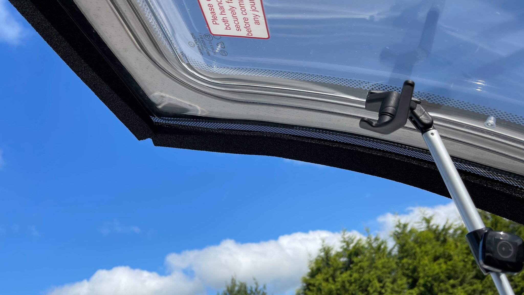

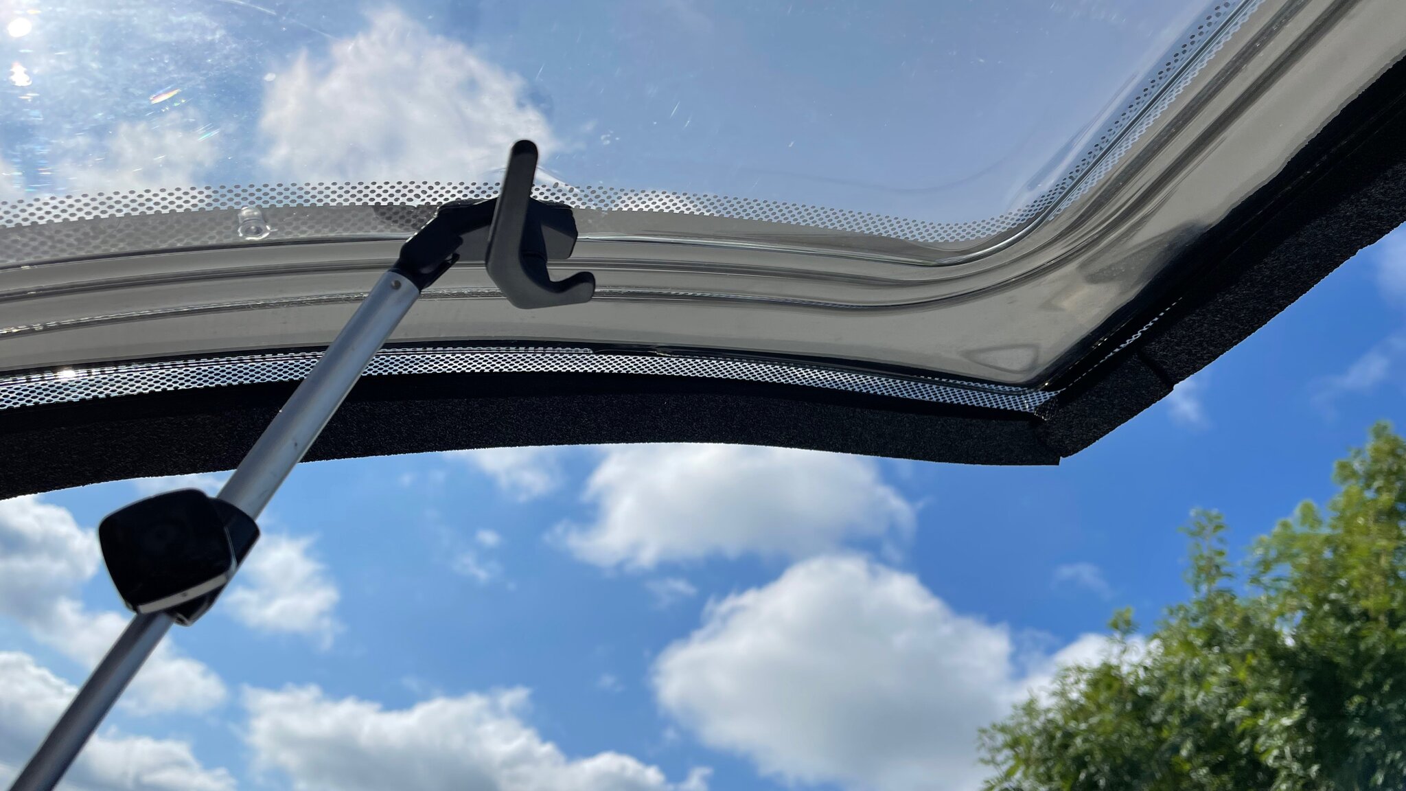

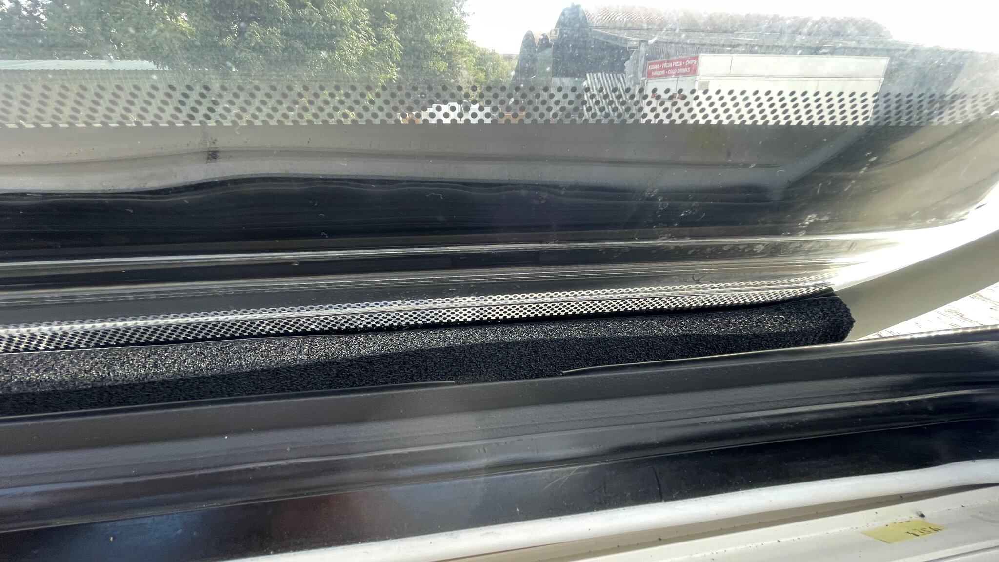

Just a little update for this thread. I used a self adhesive 1 x 1 inch foam around the skylight. It worked like a charm, there is now no 'roar' of wind on the motorway.

Good work but shame on Bailey that youve had to do all this work .
I did have the 'upgraded' seal done by Bailey within 3 months of having the bus. It cut down the noise a bit, but thought I'd go the 'extra' mile now its out of warranty and do a 'proper job'. Quite pleased with myself LOL
