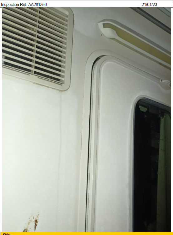

View attachment 709187 View attachment 709188
From that picture it looks like the lock catch has been taken out/off..? There appears to be no mechanism in there….😎

Btw, don't let all this talk of blue smoke take away from the more obvious faults like damp in the actual living quarters, potentially just as expensive as engine repairs.
Had hab check last August and was fine then. I've also got a decent meter and it came up dry.
