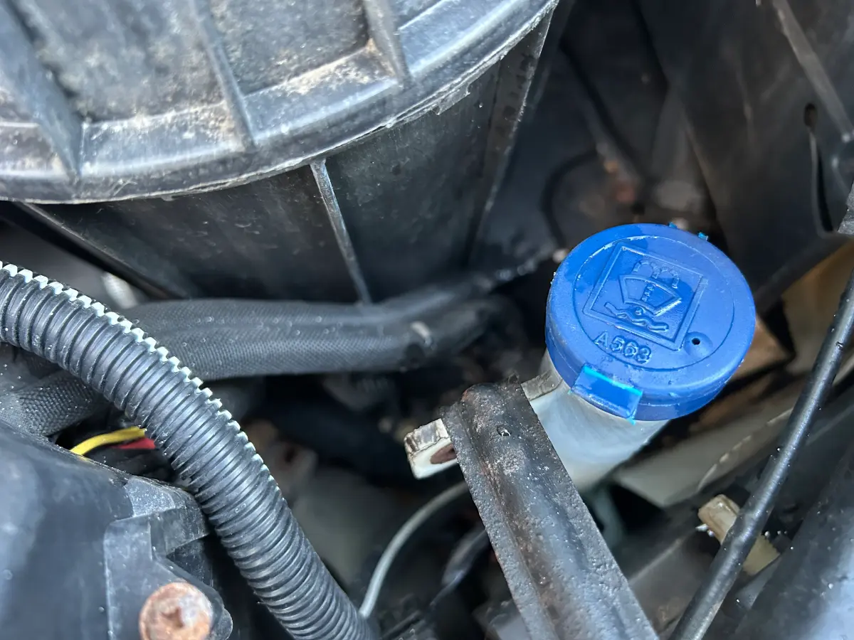

Hi I bought a 03 Bessacarr e445 last march and I have been away over Xmas/new year. As I was using the wipers a lot , I decided to check the water container for the wipers, to my surprise it was full?? My question is does it feed of the habitation water container as I am baffled to why it was full.

Arrowed is the windscreen washer fill point, the one with the little water fountain on the blue cap.
You can't usually see what level the washer bottle is at because it is hidden and, unless you have sensor and warning signal, won't know without filling it up. It doesn't matter how much you put in it will come up the tube when full. The other bottle shown in the photo with orange liquid in is the reservoir for engine coolant and has clear max and min limits. Don't put screen wash in this bottle! Similarly the smaller bottle with a yellow cap is for hydraulic brake fluid. It could be catastrophic if you contaminate this!

Can you add a photo of what you checked?
Mike.
Yes that is were I looked . I am away until the 13 so will take a photo then and post it on here.

You said you had used the wipers a lot, but no mention of using the screen washers? Try opening the bonnet and screen-wash filler, then get someone to keep their finger on the washer control. You should see the level drop fairly quickly.
Note: Before you do, make sure the wipers will clear the bonnet with it open.
Geoff
I was once filling the windscreen washer bottle which has a 'standpipe' filler coming up above the container. Affter a few seconds it overflowed so I assumed it was full.
I later dicovered that there is a small removable filter in the neck, which restricts the rate of flow. I now remove that before fillingm because I know I am filling with clear water.

Apologies yes I had used the screen wash a lot. Will try it
Yes I noticed that and do what you do. Thanks
