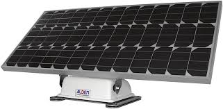

If your worried about space get Van Bitz to install an Alden Phenix
A fully automated self tracking panel, which is on average about 5 times more efficient than a flat panel of equivalent size
They have one on their exhibit unit
We had one on one of our smaller RV's that had a busy roof
Excellent bit of kit
Took a while to find a supplier of this German Oyster device who mentioned a price on their website - from £2,150.00
