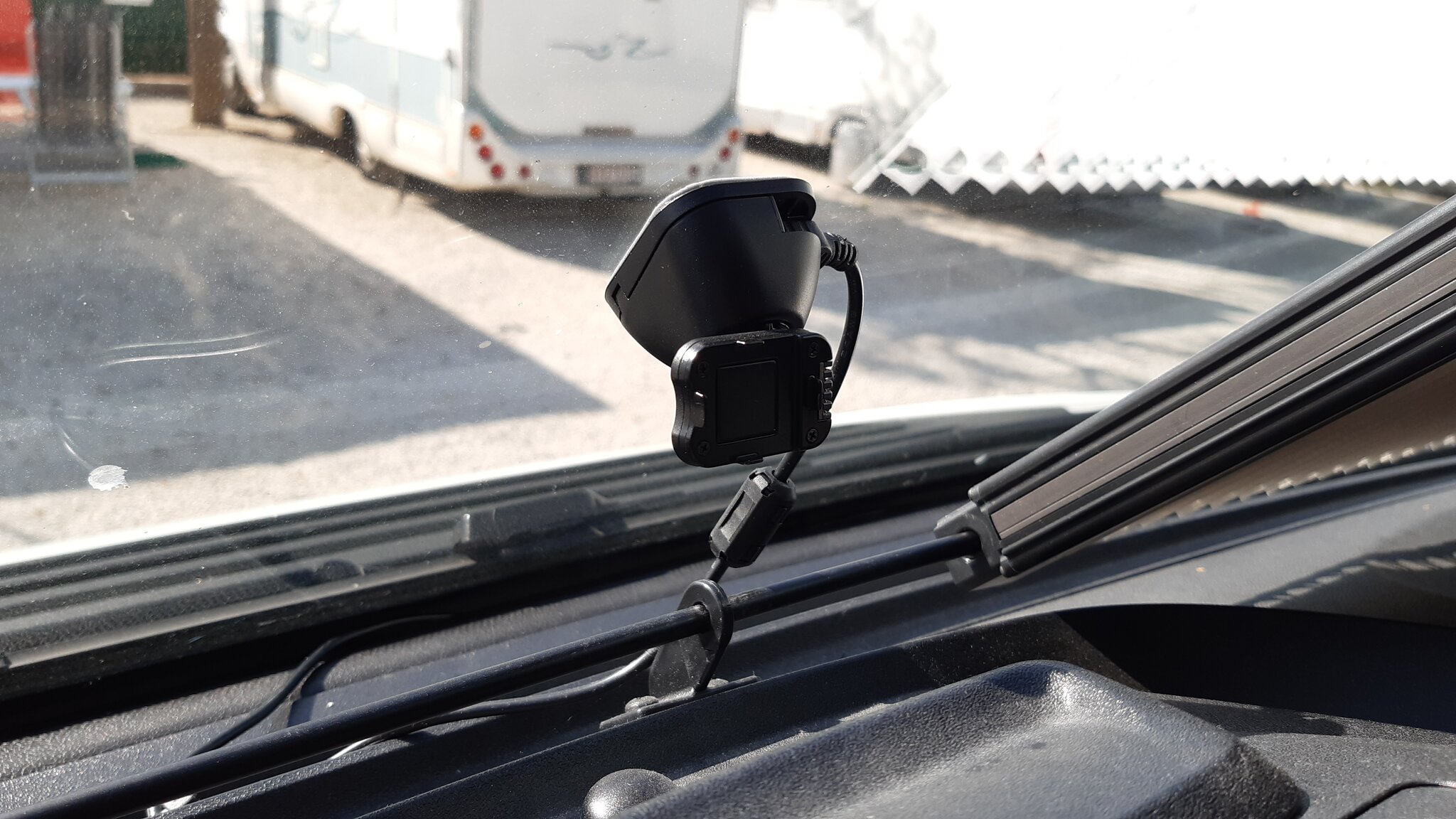

Can you close front remiss blinds with the click and go/pro mount in place
I've mounted mine at the bottom of the screen because the blinds wouldn't close with it at the top. It's fine as it's still higher than most cars

Sorry, looking at my handbook, it may not actually be spare - (our handbook is in German) the one I’ve used is F31. Easy to reach and out of the way at the top left of the fuse board. I’ve used the next-base hardwire kit, mini fuse adapter supplied to tap into the fuse holder.
I’ve attached photos of the fuse board and dashcam . (Our van is LHD to avoid any confusion).
This fuse is ignition controlled so it goes on and off with the ignition.
