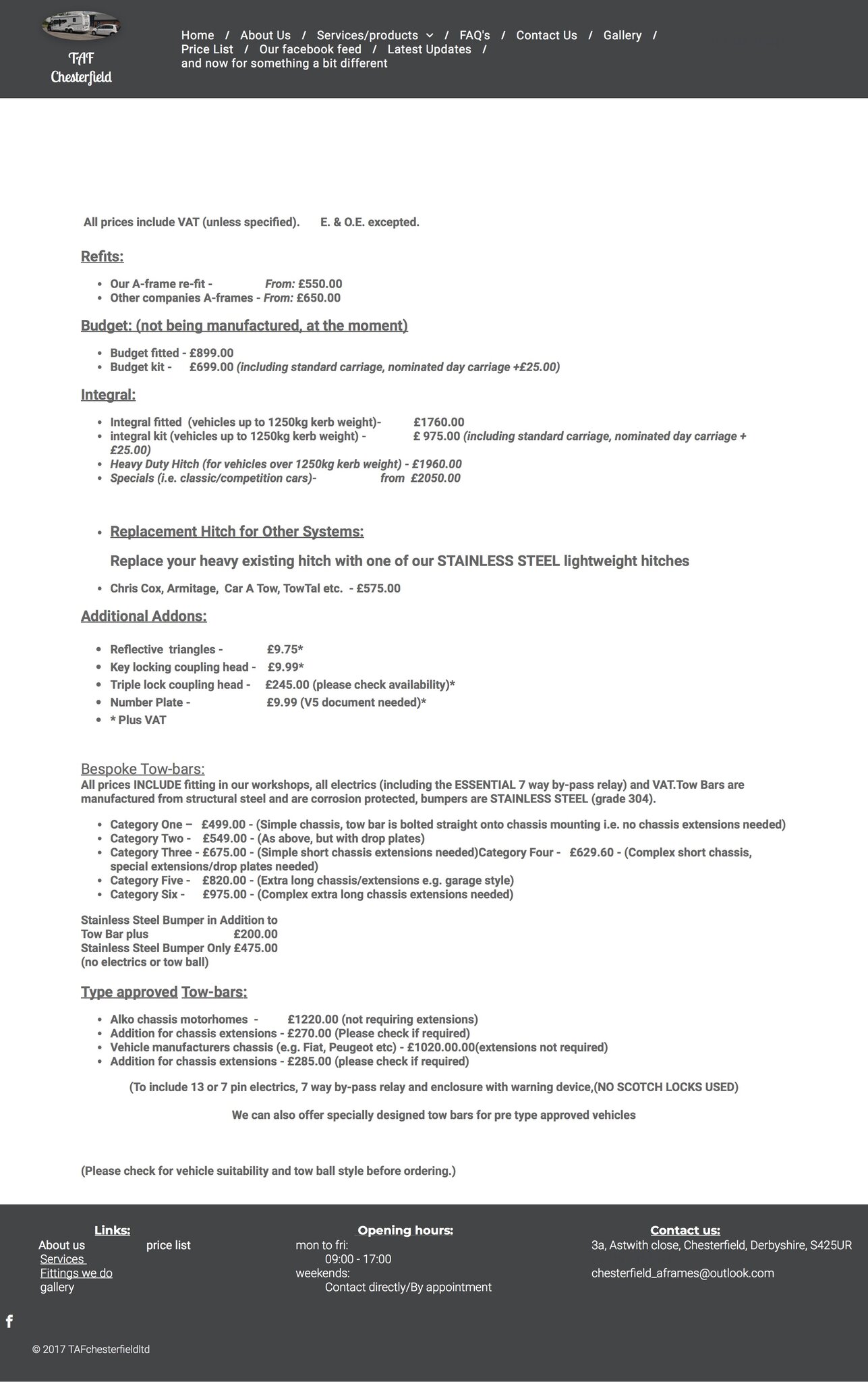

Certainly can't see any that cheap fitted online. Cheapest I've seen is around £1600 but many over £2k
An example of prices
