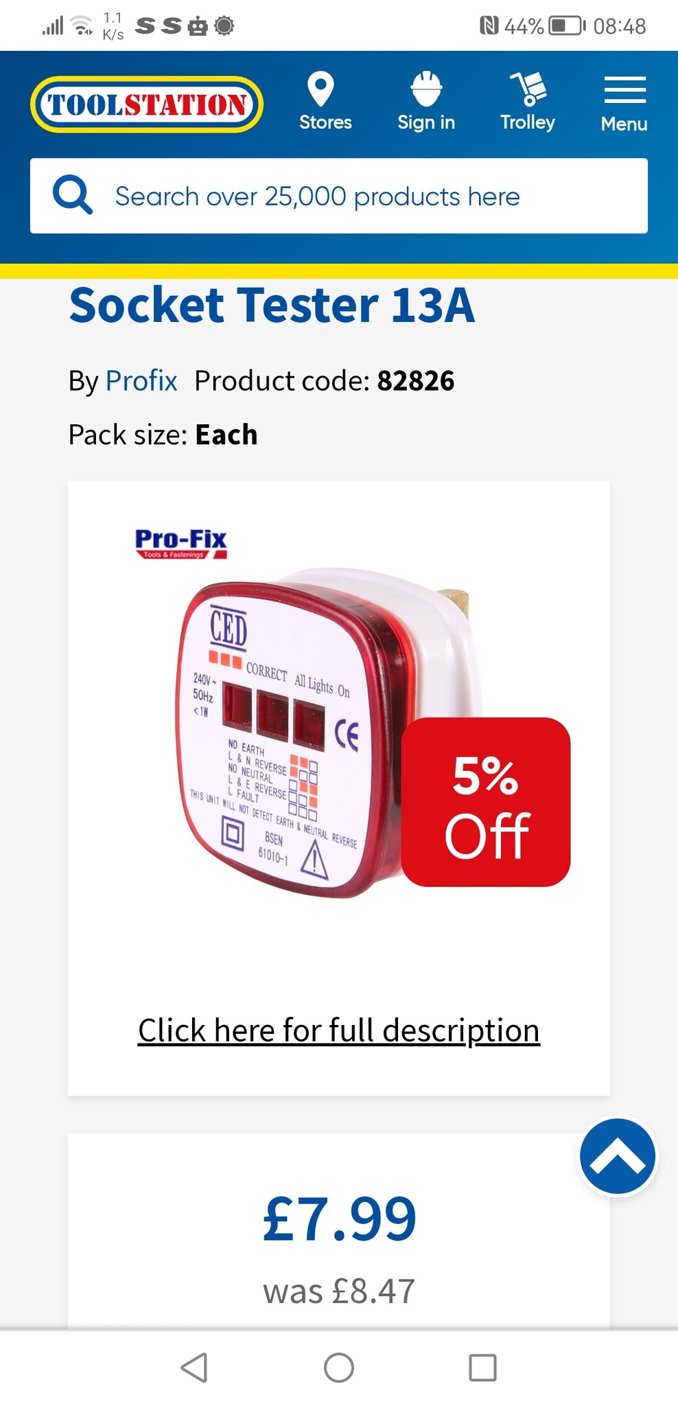

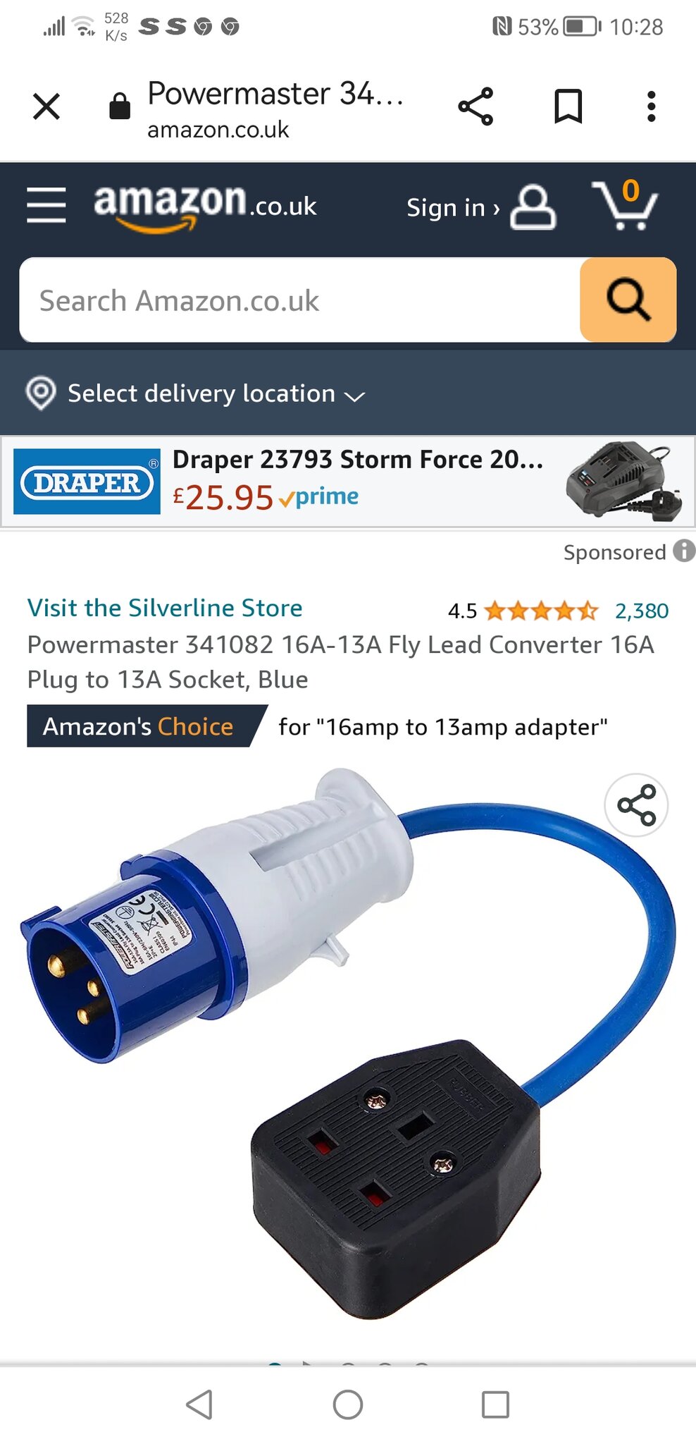

Terrible idea !! Very dangerous.
What you need is one of the the below, either test the socket in your motorhome after you have hooked up, or make up a 240v Reyroll plug (the round blue plugs that go into the site post) to a 240v trailing socket on a 6" lead. Plug that into the post with the mains tester into the training socket. Totally safe.

The tester is checking that the site hook up is wired correctly. The most common problem is a reversed polarity - which is when the positive and negative wires are reversed. The power will work ok, but if there was say a fault in one of your appliances there is a potential danger. The tester also checks other things like the Earth connection.
In France, it was common to find reverse polarity on sites (much less these days) so many like me carry an adaptor plug for the hook up connection which has the wiring set to reverse the polarity back, after using the little tester plug mentioned by me and others. You can buy these cheaply online or just make one if you are able.
The tester plug requires no skills - just plug it into your 13amp socket anywhere in your Motorhome, camper or caravan! Simples!

The problem with that simple bulb tester is that it only tests for power, it doesn't test for dangerous faults like missing earth. You can use a 13A socket tester with a travel adapter to test one of those European '2-pin' sockets. Of course if you're a true geek you could buy a European socket tester. And with a blue plug to 13A socket adapter you can test the hookup post and hookup cable too, as Sandancers says.
Too Bulky.
I use one of these ...
and one of these
(You can also check the voltage with that tester. Very handy)
Without doubt your device is a better idea, but to be honest I just did a quick search.
I had (and still have) a lead similar to the one you posted :) (I made mine with a waterproof 13A Socket as I used it mainly in the garden with a mower, so wet grass ..... :( ). And then someone showed me their plug-in adapter and it is so much nicer to use so I bought one. Big Improvement :D
